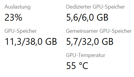

I can only compare it to Cycles at this point. And if Cycles seems to take advantage of that shared memory - with that very GPU and on Windows as well - I can't see, how the GPU should not be able to handle it. But of course I can't say what the task manager is actually displaying there and what happens behind the curtain. I have a GTX 980 Ti and a GTX 1060.
From what a little googling has show, Octane Render also seems to support OOC memory handling - probably on Windows as well.
[EDIT] Attached are the GPU stats of the same scene rendered in Cycles (at a higher resolution of 9600px in width). As you can see, there are 5.7GB of RAM used for the GPU which in total results in 11.3GB.

Cycles uses tile rendering, the option of this thread is for progressive rendering (i.e. you should use Cycles X).

AndreasResch wrote: Mon Jun 21, 2021 11:33 am I don't see what tiled rendering has to to with the capability to use shared memory or not.
One allocated a 7200x4800 while the other allocated a 64x64 film, I don't see how you can not see the difference.
