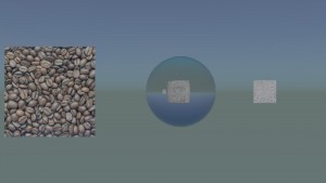

This is an example of the policy working with usual test scene:
[SDL][0.001] Creating TX image for file:  scenes/randomizedtiling/pattern-3.jpg
[SDL][0.041] Probe ImageMap: scenes/randomizedtiling/pattern-3.jpg.tx [from 512x512 to 64x64]
[SDL][0.041] Reading texture map: scenes/randomizedtiling/pattern-3.jpg.tx
[SDL][0.041] Mip map available: [512x512][256x256][128x128][64x64][32x32][16x16][8x8][4x4][2x2][1x1]
[SDL][0.041] Reading mip map level: 3
[SDL][0.043] Texture definition: 140707101904392Color
[SDL][0.043] Creating TX image for file:  scenes/randomizedtiling/pattern-7.jpg
[SDL][0.087] Probe ImageMap: scenes/randomizedtiling/pattern-7.jpg.tx [from 512x512 to 64x64]
[SDL][0.087] Reading texture map: scenes/randomizedtiling/pattern-7.jpg.tx
[SDL][0.087] Mip map available: [512x512][256x256][128x128][64x64][32x32][16x16][8x8][4x4][2x2][1x1]
[SDL][0.087] Reading mip map level: 3
[SDL][0.088] Texture definition: 140707106223624Color
[SDL][0.088] Creating TX image for file:  scenes/randomizedtiling/pattern-9.jpg
[SDL][0.134] Probe ImageMap: scenes/randomizedtiling/pattern-9.jpg.tx [from 512x512 to 64x64]
[SDL][0.134] Reading texture map: scenes/randomizedtiling/pattern-9.jpg.tx
[SDL][0.134] Mip map available: [512x512][256x256][128x128][64x64][32x32][16x16][8x8][4x4][2x2][1x1]
[SDL][0.134] Reading mip map level: 3
[LuxCore][0.506] Optimal image map size preprocess thread count: 24
[SDL][0.816] Image maps "scenes/randomizedtiling/pattern-3.jpg" optimal resize: 512x512 => 533x533
[SDL][0.816] Image maps "scenes/randomizedtiling/pattern-7.jpg" optimal resize: 512x512 => 266x266
[SDL][0.816] Image maps "scenes/randomizedtiling/pattern-9.jpg" optimal resize: 512x512 => 133x133
[SDL][0.816] WARNING: image maps "scenes/randomizedtiling/pattern-3.jpg" too small !
[SDL][0.816] Reading texture map: scenes/randomizedtiling/pattern-3.jpg.tx
[SDL][0.817] Mip map available: [512x512][256x256][128x128][64x64][32x32][16x16][8x8][4x4][2x2][1x1]
[SDL][0.817] Reading mip map level: 0
[SDL][0.838] Image maps "scenes/randomizedtiling/pattern-3.jpg" scaled: 512x512 => 512x512
[SDL][0.838] Reading texture map: scenes/randomizedtiling/pattern-7.jpg.tx
[SDL][0.839] Mip map available: [512x512][256x256][128x128][64x64][32x32][16x16][8x8][4x4][2x2][1x1]
[SDL][0.839] Reading mip map level: 0
[SDL][0.859] Image maps "scenes/randomizedtiling/pattern-7.jpg" scaled: 512x512 => 512x512
[SDL][0.859] Reading texture map: scenes/randomizedtiling/pattern-9.jpg.tx
[SDL][0.860] Mip map available: [512x512][256x256][128x128][64x64][32x32][16x16][8x8][4x4][2x2][1x1]
[SDL][0.860] Reading mip map level: 1
[SDL][0.879] Image maps "scenes/randomizedtiling/pattern-9.jpg" scaled: 512x512 => 256x256
[SDL][0.879] Memory required for original Image maps: 2304Kbytes
[SDL][0.879] Memory required for MIPMAPMEM Image maps: 1728Kbytes
[SDL][0.879] Applying resize policy MIPMAPMEM time: 0.4secs
You can see the different result in term of memory usage of different policies:
- Memory required for original Image maps: 2,304Kbytes
- Memory required for MIPMAPMEM Image maps: 1,728Kbytes
- Memory required for MINMEM Image maps: 879Kbytes

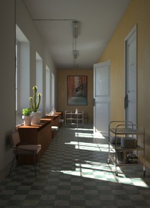

A real world test
The results of rendering of HallBench scene with different policies are:
- Memory required for original Image maps: 272,710Kbytes
- Memory required for MIPMAPMEM Image maps: 156,862Kbytes
- Memory required for MINMEM Image maps: 113,532Kbytes
As you see, MIPMAPMEM still deliver a very significative memory usage reduction without most of the pre-processing time cost of MINMEM.
