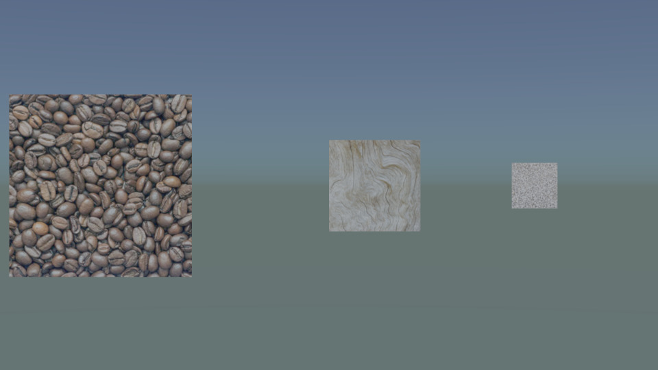

This is reference rendering (all the image maps are 512x512):
Using:
[LuxRays][0.524] [Device GeForce RTX 2070 SUPER CUDAIntersect] ImageMaps buffer size: 5376KbytesUsing:
[LuxRays][1.160] [Device GeForce RTX 2070 SUPER CUDAIntersect] ImageMaps buffer size: 4099KbytesThe log show what MINMEM does:
[LuxCore][0.593] Resize policy preprocess thread count: 24
[SDL][0.855] Image maps "scenes/randomizedtiling/pattern-3.jpg" optimal resize: 512x512 => 533x533
[SDL][0.855] Image maps "scenes/randomizedtiling/pattern-7.jpg" optimal resize: 512x512 => 266x266
[SDL][0.855] Image maps "scenes/randomizedtiling/pattern-9.jpg" optimal resize: 512x512 => 133x133
[SDL][0.855] WARNING: image maps "scenes/randomizedtiling/pattern-3.jpg" too small !
[SDL][0.855] Reading texture map: scenes/randomizedtiling/pattern-3.jpg
[SDL][0.880] Image maps "scenes/randomizedtiling/pattern-3.jpg" scaled: 512x512 => 512x512
[SDL][0.880] Reading texture map: scenes/randomizedtiling/pattern-7.jpg
[SDL][0.942] Image maps "scenes/randomizedtiling/pattern-7.jpg" scaled: 512x512 => 266x266
[SDL][0.942] Reading texture map: scenes/randomizedtiling/pattern-9.jpg
[SDL][0.998] Image maps "scenes/randomizedtiling/pattern-9.jpg" scaled: 512x512 => 133x133
[SDL][0.998] Applying resize policy MINMEM time: 0.4secs

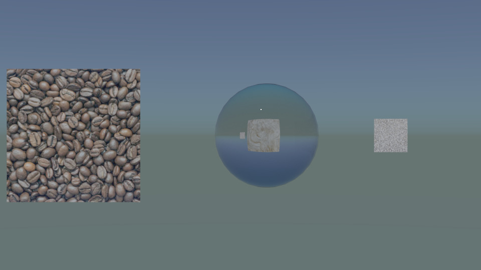

Now let's render with the same scene at a lower resolution (960x540 instead of 1920x1080):
MINMEM uses even less ram thanks to the lower rendering resolution:
[LuxRays][0.923] [Device GeForce RTX 2070 SUPER CUDAIntersect] ImageMaps buffer size: 3343KbytesCode: Select all
[LuxCore][0.652] Resize policy preprocess thread count: 24
[SDL][0.726] Image maps "scenes/randomizedtiling/pattern-3.jpg" optimal resize: 512x512 => 266x266
[SDL][0.726] Image maps "scenes/randomizedtiling/pattern-7.jpg" optimal resize: 512x512 => 133x133
[SDL][0.726] Image maps "scenes/randomizedtiling/pattern-9.jpg" optimal resize: 512x512 => 66x66
[SDL][0.726] Reading texture map: scenes/randomizedtiling/pattern-3.jpg
[SDL][0.793] Image maps "scenes/randomizedtiling/pattern-3.jpg" scaled: 512x512 => 266x266
[SDL][0.793] Reading texture map: scenes/randomizedtiling/pattern-7.jpg
[SDL][0.852] Image maps "scenes/randomizedtiling/pattern-7.jpg" scaled: 512x512 => 133x133
[SDL][0.852] Reading texture map: scenes/randomizedtiling/pattern-9.jpg
[SDL][0.907] Image maps "scenes/randomizedtiling/pattern-9.jpg" scaled: 512x512 => 66x66
[SDL][0.907] Applying resize policy MINMEM time: 0.3secs

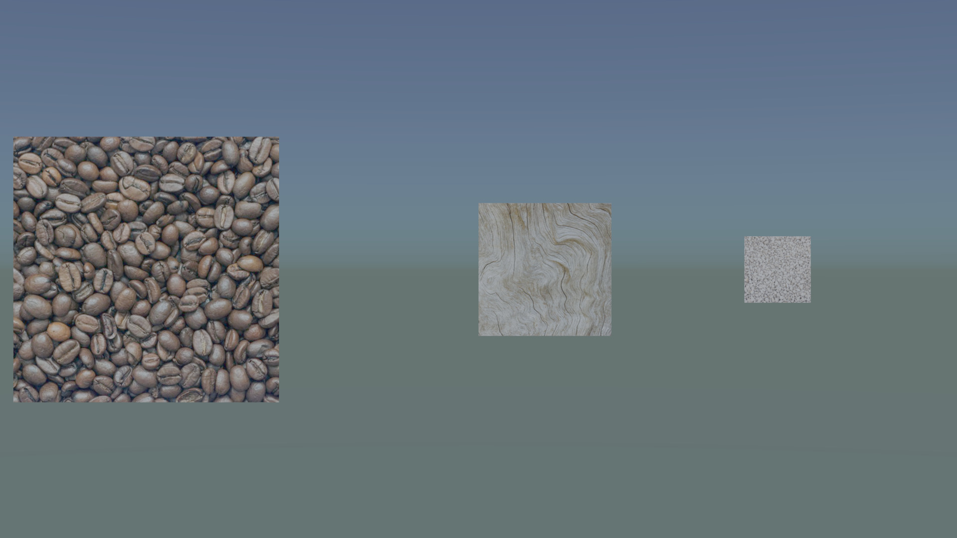

It uses even less ram because the optimal size of the middle quad is even smaller:
[LuxCore][0.625] Resize policy preprocess thread count: 24
[SDL][0.702] Image maps "scenes/randomizedtiling/pattern-3.jpg" optimal resize: 512x512 => 266x266
[SDL][0.702] Image maps "scenes/randomizedtiling/pattern-7.jpg" optimal resize: 512x512 => 71x71
[SDL][0.702] Image maps "scenes/randomizedtiling/pattern-9.jpg" optimal resize: 512x512 => 66x66
[SDL][0.702] Reading texture map: scenes/randomizedtiling/pattern-3.jpg
[SDL][0.776] Image maps "scenes/randomizedtiling/pattern-3.jpg" scaled: 512x512 => 266x266
[SDL][0.776] Reading texture map: scenes/randomizedtiling/pattern-7.jpg
[SDL][0.843] Image maps "scenes/randomizedtiling/pattern-7.jpg" scaled: 512x512 => 71x71
[SDL][0.843] Reading texture map: scenes/randomizedtiling/pattern-9.jpg
[SDL][0.901] Image maps "scenes/randomizedtiling/pattern-9.jpg" scaled: 512x512 => 66x66
[SDL][0.901] Applying resize policy MINMEM time: 0.3secs
