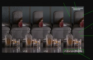

Ok,now things are pretty clear, we NEED OIDN 1.4 in LuxCore 2.6 ASAP, check this results:
https://twitter.com/attila_afra/status/ ... 8465773571

excellent result :o
perhaps now animations on small samples will not flicker :!:

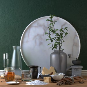

I have updated the Linux daily builds with Intel OIDN v1.4.0 (other OS will follow) and added the support for auxiliary buffers pre-filtering.
This is a 32 samples/pixel rendering:
and this is the denoised version without pre-filtering:

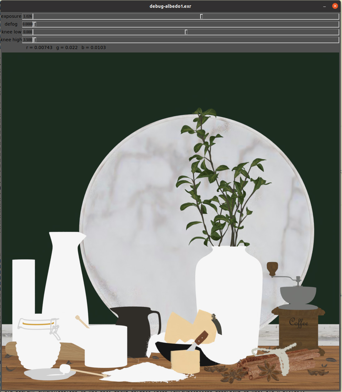

This is the Albedo AOV before pre-filtering:
and this after pre-filtering:
and this is the denoised version with pre-filtering:
To recap, without pre-filtering Vs. with prefiltering:
This isn't a practically good test scene to highlight the difference but I would say the improvement is there.

Due to the capability to pre-filtering the Albedo AOV, it may worth re-evaluating how albedo of specular surfaces is done (i.e. glass, mirror, etc.).

Yep, the improvement is there, and yes, Albedo with glass and reflections would be very welcome.
Maybe you can create a new Denoising Albedo, like what Cycles does, so the original Albedo remains untouched as it is correct.
