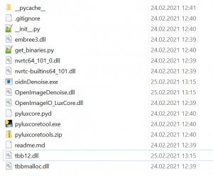

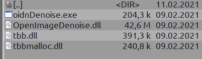

0. DL: oidn-1.3.0.x64.vc14.windows.zip (directly from github)
1. Remove following files from your disk located in "...\BlendLuxCore\bin\"
2. Copy/Paste or Move following files from downloaded package "oidn-1.3.0.x64.vc14.windows.zip\oidn-1.3.0.x64.vc14.windows\bin\" to that same location
Enjoy :)

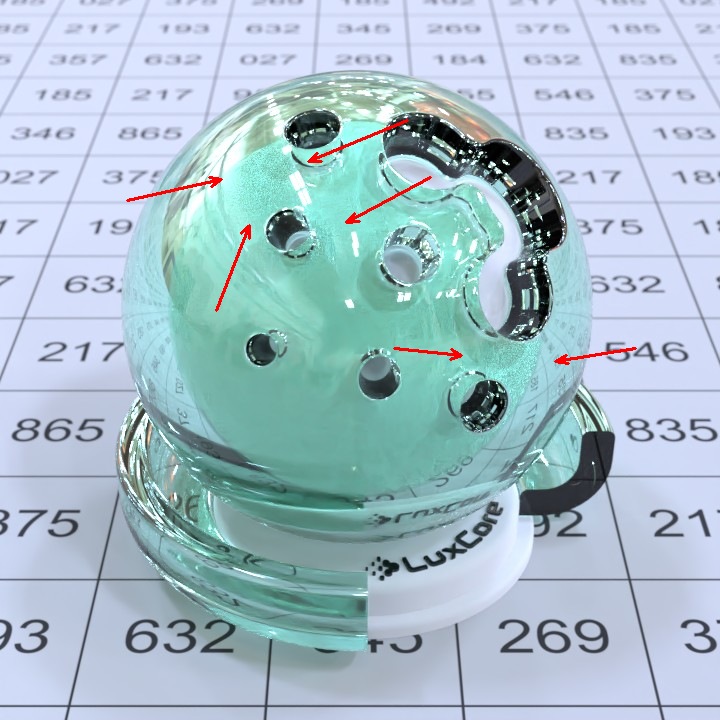

anyway, I occassionally do check its quality

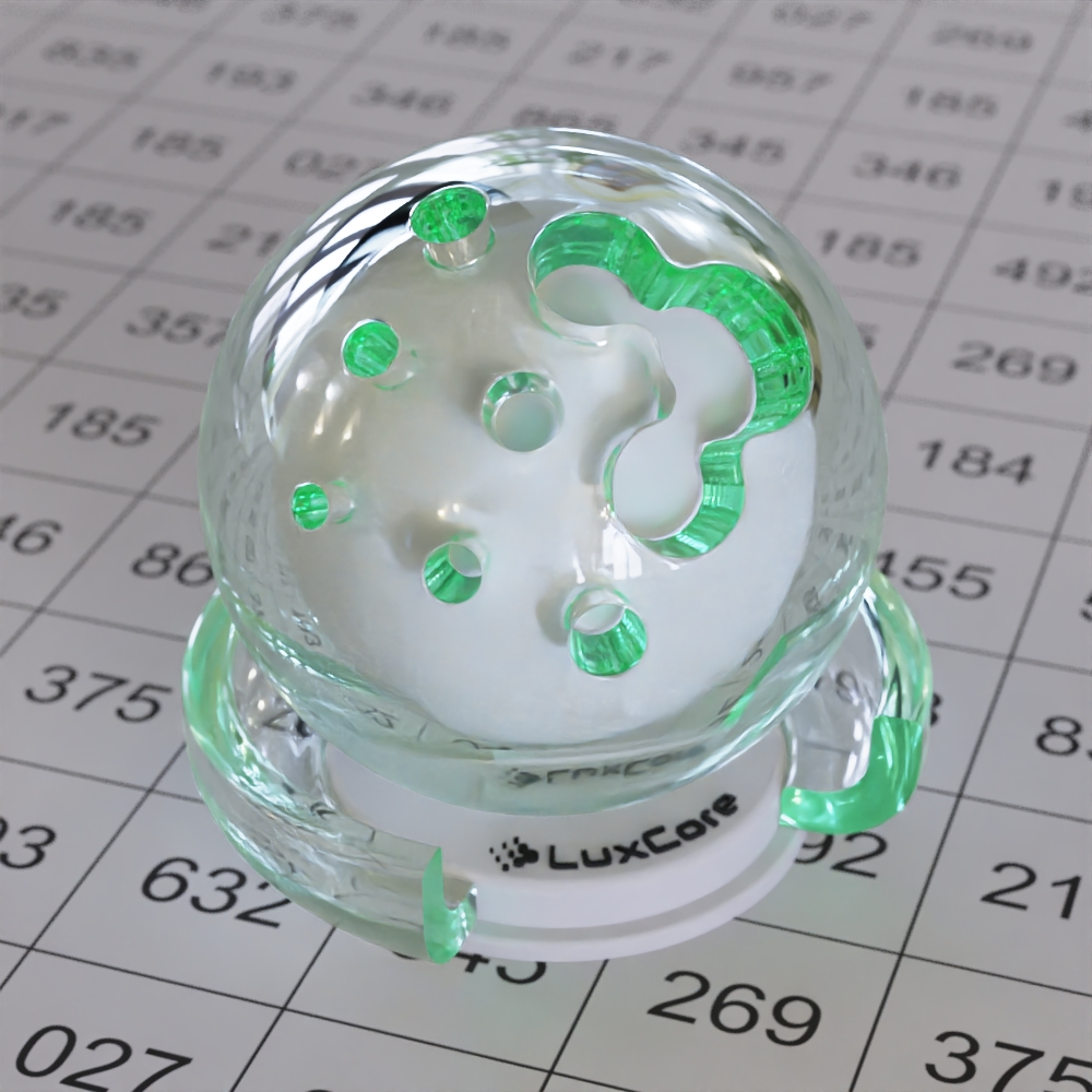

f.e., here's one of older results w/ v0.9.0 (done on 2019 jun 26) where you can observe issue with glass
:) nice. And yeah it is truly clean image than old one. Will try myself with my "new toy pc" 😎
