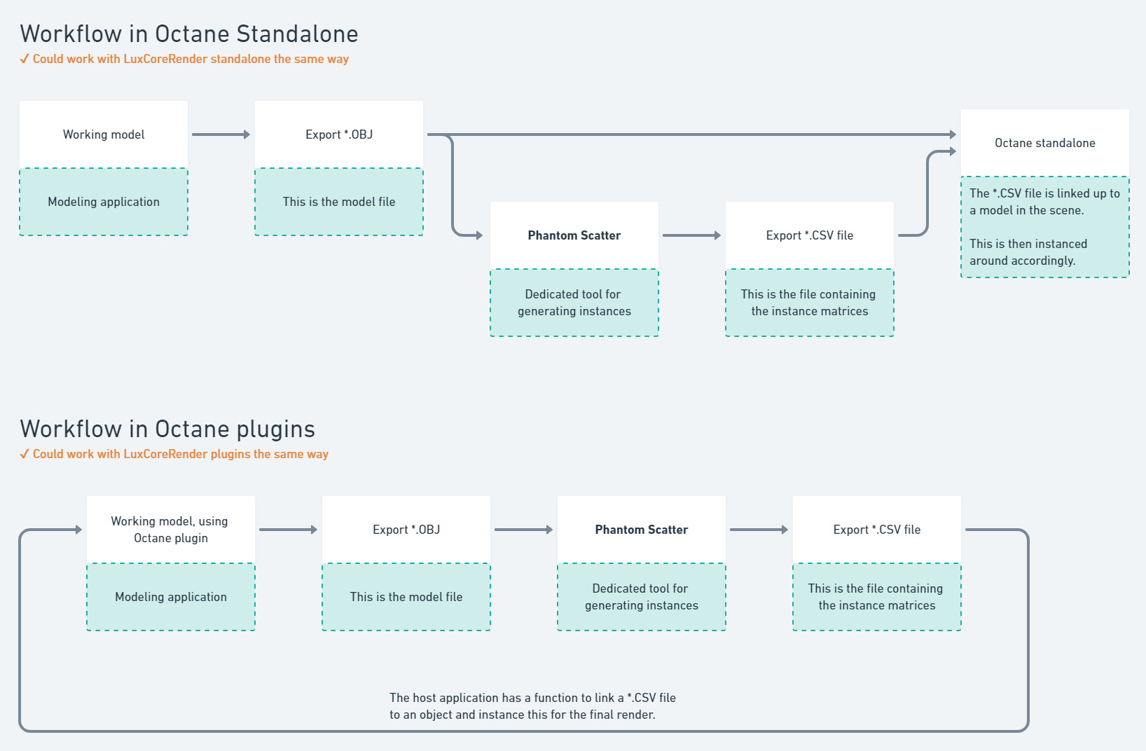

Workflow looks like this:

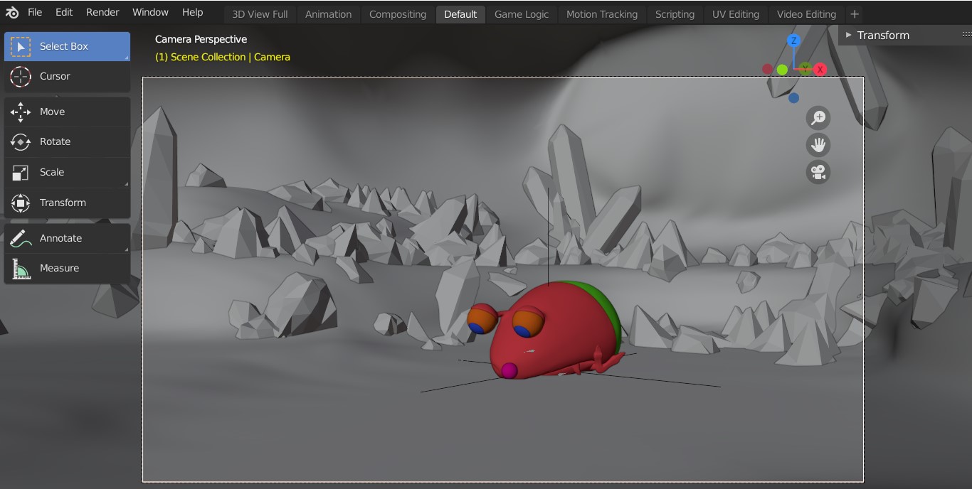

Scene in Blender:

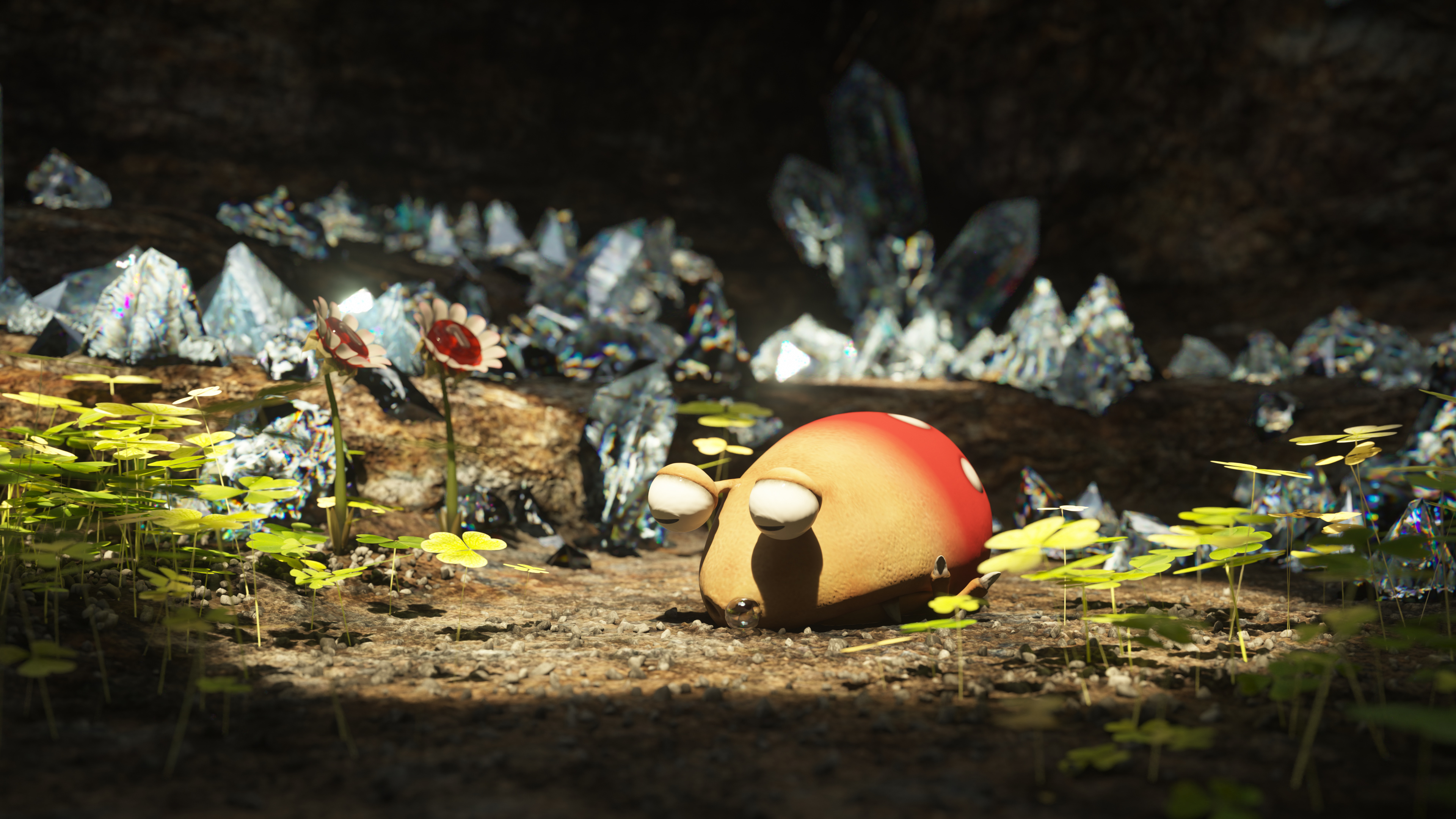

Scene in Octane standalone + scattering:

Phantom107 wrote: Sun Nov 15, 2020 11:09 pm Workflow looks like this:
I suggest you to focus only on the second scenario: LuxCoreRender standalone is intended as a sample to show developers how to use LuxCore API. It is not really intended for end users (and it is not used by 99% of them).
It may be useful for testing/development but it doesn't make sense as target for a commercial product.

As far as I can see, your (second) scenario requires:
1) to extend LuxCore SDL to support your .csv file format. Can you post a .csv example file ? I would like to check exactly what kind of information are there.
2) to extend BlendLuxCore to have some kind of support for a proxy object. A virtual object referring the .csv file. BlendLuxCore could even further automate the process by exporting the .obj file and running PhantomScatter executable.

Thanks for the reply,
I agree only scenario 2 is viable, since LuxCoreRender doesn't have a standalone dedicated UI. I did want to explain both to make myself clear.
