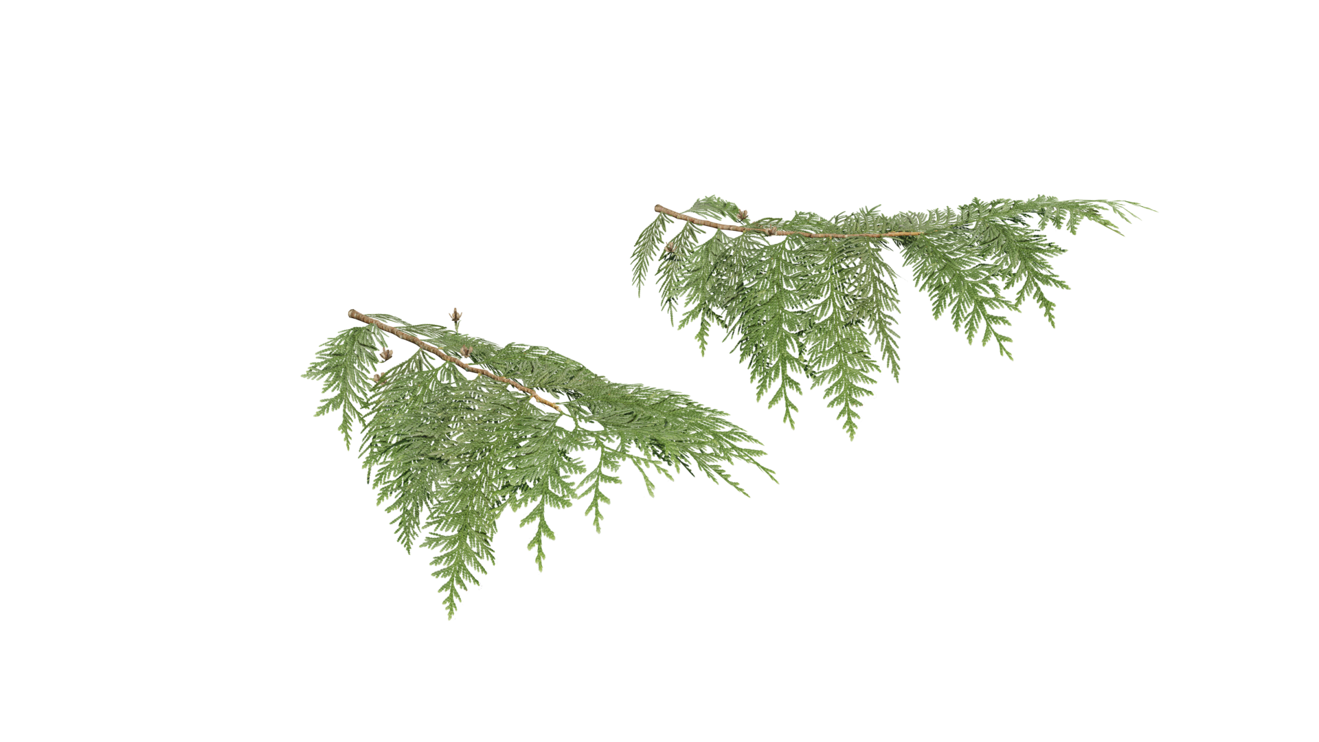

Using same file and mirroring the object Y Global you can see the difference below:

Referring to previous post, if it is not obvious, the top image is Cycles and the bottom image is Lux.
If the normal is not flipped, material will not be. If it is flipped, the material will be. If you select, inside Blender, the original object and the mirrored one, how do the normals look ?
The normals do not flip.

Post by CEROE » Tue Sep 29, 2020 11:00 pm
The normals do not flip on the mirrored object, but the frontside/backside material switches in Lux. This does not happen in Cycles (Top render in previous post).
Below shows the normals of the mirrored object.
Lux is switching the frontside/backside material on a mirrored object.
