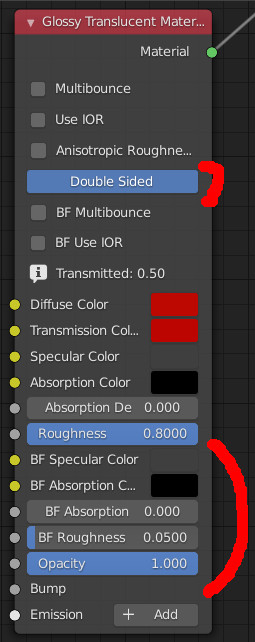

CEROE wrote: Thu Sep 17, 2020 2:19 am There are a couple issues:
The backside seems to be extra glossy. I have tried the same settings for each, and the backside is different.
I'm trying to reproduce your problem but I'm unable at the moment: can you post a test scene ?

Here are the two issues:
1) The backside material is glossier than the frontside.
2) The sides switch when mirroring the objects.

Re: TwoSided material
CEROE wrote: Mon Sep 28, 2020 10:21 pm The "Two-Sided_Issues-NoImages.blend" file demonstrates the two issues. Can you download and see if it is benefitial to you?
Actually, it is the definition of your material to be asymmetric, you need to click on "Double Sided" and to use the same parameters for front and back face ("BF"):
Once you have done that, you should get the sane results.
@B.Y.O.B: BlendLuxCore seems to leave the default values for the back face if the "Double Sided" option is not used. This is probably a bug and I assume people expect to have the same parameters both for front and back face.
Dade wrote: Tue Sep 29, 2020 9:54 am @B.Y.O.B: BlendLuxCore seems to leave the default values for the back face if the "Double Sided" option is not used. This is probably a bug and I assume people expect to have the same parameters both for front and back face.
Fixed. I had a wrong assumption about how the properties of this material work.
