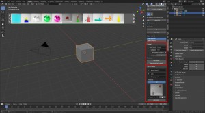

I have added the very first implementation of local asset support. It is very basic and probably has a lot of bugs but here it is.
You can add a asset by selecting it and type in the name and category in the Local panel. After that you could select an thumbnail image or let the addon render one (default) with the given amount of samples.
The asset will be stored in the folder for the asset_types model or material
%USERPROFILE%\LuxCoreOnlineLibrary_data\<asset_type>\local
And the thumbail will be stored in the folder
%USERPROFILE%\LuxCoreOnlineLibrary_data\<asset_type>\preview\local
If you already have an asset in a blend file and a thumbnail image, you can copy the files in the above mentioned folder and hit the 'Search new local assets' button in the local panel. After that there should be a scan result list with the new assets which can be added after that.
With the local only option in the asset panel you can switch between all assets or only the local ones.
There will be more features like editing the local asset list or removing of assets.

Post by Sharlybg » Wed Jul 29, 2020 9:01 pm
That is a great news indeed.It is more elaborated than what i had in mind. very great job ! :D
I'm currently testing it.
But i struggle. i have created a local folder as you say (one for preview thumbnails and one for model). Now i don't know if i should create subfolders for each local categories.
Posts: 2576
Post by Sharlybg » Wed Jul 29, 2020 9:22 pm
Ok i have first result both thumbnails and blend shouldn't be in a sub folder in local folder to be seen.
Look like a the addon need to be connected to internet before it allow new local asset to be add and seen in the main preview bar.
I mean the search work without internet so do the add asset button. But after that the bar won't show again until i connect the internet.
Posts: 2576
Post by Sharlybg » Wed Jul 29, 2020 9:55 pm
Ok i understand now categories are created by the .json file not subfolder. ;)
