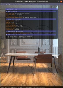

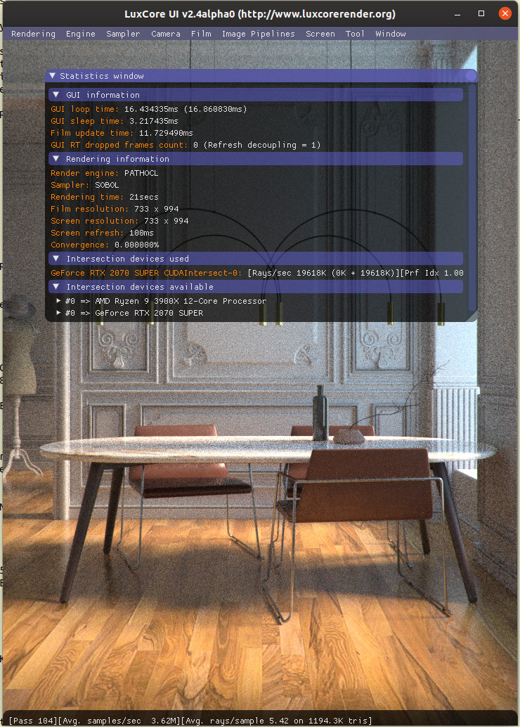

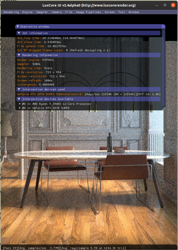

This mode is slower (it renders about 32 samples per pixel instead of 1) to cover all the image but is more cache-friendly. If you compare the numbers with the "Progressive" mode, it is about a 5%-10% faster:
