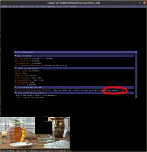

You can enable OoC rendering by just flipping a flag:
opencl.outofcore.enable = 1
Some buffer will be than allocate and marked as "OUT OF CORE":

As any cache, it works only if most samples will reuse the same data (see the new Random/Sobol sampler options below). Otherwise the rendering can become very very slow with an endless transfer of data between CPUs and GPUs through the (slow) PCIe bus.
