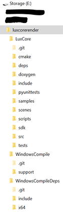

Ok, beginning to think I'm actually doing something stupid trying to compile here. I've tried VS2013, VS2015, and VS2017 compilers and get the same error on all three. To be fair, none of the compilers are actually the correct one as specified in the readme (more on that below, <shakes fist at Microsoft>), but the fact that they're all throwing the same error leads me to believe I've set something up wrong. Here are screenshots of one of my compile attempts, and the first levels of my directory structure. Am I missing something?
As for Visual Studio, apparently VS2013 isn't packaged with the 2013 command line - it's packaged with the 2012 command line. And I still haven't found a native x64 version of 2013. I thought maybe VS2015 x64 would be packaged with the 2013 command line, but no it actually has its own 2015 command line. So for whatever reason the VS2013 64-bit compiler is a singularly difficult piece of software to locate these days. Here's hoping the errors I'm getting so far are on my end, and I can ultimately verify that some other versions of VS actually work fine to compile Lux ... that would at least save others the trouble I'm having.

gecko wrote: Wed Jan 03, 2018 5:59 pm Ok, beginning to think I'm actually doing something stupid trying to compile here. I've tried VS2013, VS2015, and VS2017 compilers and get the same error on all three. To be fair, none of the compilers are actually the correct one as specified in the readme (more on that below, <shakes fist at Microsoft>), but the fact that they're all throwing the same error leads me to believe I've set something up wrong. Here are screenshots of one of my compile attempts, and the first levels of my directory structure. Am I missing something?
I think to know what is going on, we didn't noticed because we have all cmake installed in our systems, you simply need to install cmake (https://cmake.org/files/v2.8/cmake-2.8.12-win32-x86.exe even the latest version should work but better safe than sorry). You also need to have cmake.exe in your PATH variable (cmake installer should ask you to add cmake.exe to PATH system variable).
In the past, we had cmake.exe included in WindowsCompileDeps repository so no one noticed you have now to install cmake too.

Good news! Installing CMake was the problem. I guess I saw the /cmake directory and assumed that's what it was looking for, never thought that it might be looking for an additional piece of software. With that out of the way, I can confirm that:
- VS 2015 x64 can compile LuxCoreRender successfully.
- VS 2017 x64 can compile LuxCoreRender successfully.
