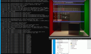

Still I cannot select devices in LuxCoreUI, same error as in BlendLuxCore:

epilectrolytics wrote: Sun Apr 26, 2020 7:58 am Still I cannot select devices in LuxCoreUI, same error as in BlendLuxCore:
Did you modify the .cfg file as mentioned?
Posts: 814
Re: Windows Build FAILED
Post by epilectrolytics »
kintuX wrote: Sun Apr 26, 2020 9:33 am Did you modify the .cfg file as mentioned?
That doesn't change anything, the Cornell file works the same with modification, once I try to change devices via UI editor there is an exit.
Cuda clearly works, sorting out devices not (yet) ;)
I should have fixed this problem, this is likely to have fixed BlendLuxCore problem too.
Posts: 814
Dade wrote: Sun Apr 26, 2020 11:07 am
Sadly no, BlendLuxCore still gives an error.
