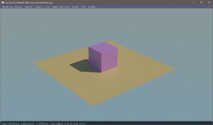

- So I exported the scene, set .cfg to
opencl.devices.select = 0011
ran luxcoreui.exe and loaded the scene...
and "Compiling" took forever = Kernels compilation time: 155375ms but when it showed up was already @ 2412 samples - :lol: great!!!
PS
Also note: OCL too, takes foooreeveeer to compile now :shock: :P
