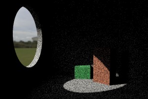

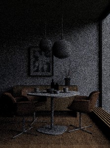

An 1 samples/pixel without any cache (only importance sampling):

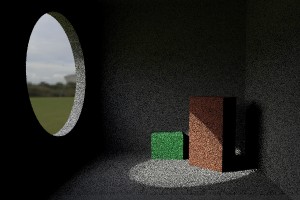

An 1 samples/pixel with old Env. Light Visibility Cache:
An 1 samples/pixel with new 2 levels Env. Light Visibility Cache:
Note: all 3 methods are unbiased and converge to the correct solution on the long run.
As you can see, the new version deliver a more uniform and slightly less noisy result (at a fraction of the pre-processing time). You can think at the new solution like a mix of the first two:

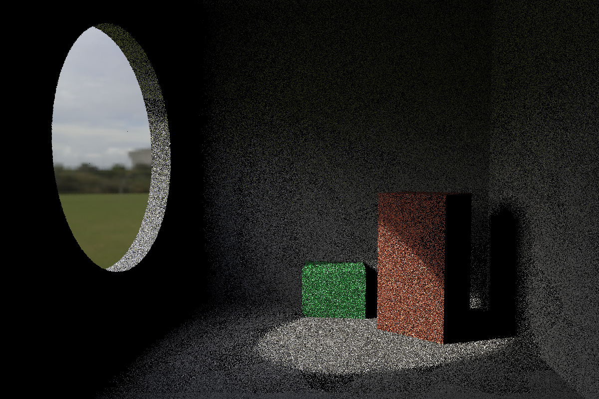

This is a 1 sample/pixel render with low quality setting and few millisecond of pre-processing:
This is a 1 sample/pixel render with high quality setting and and about 10 seconds of pre-processing:
