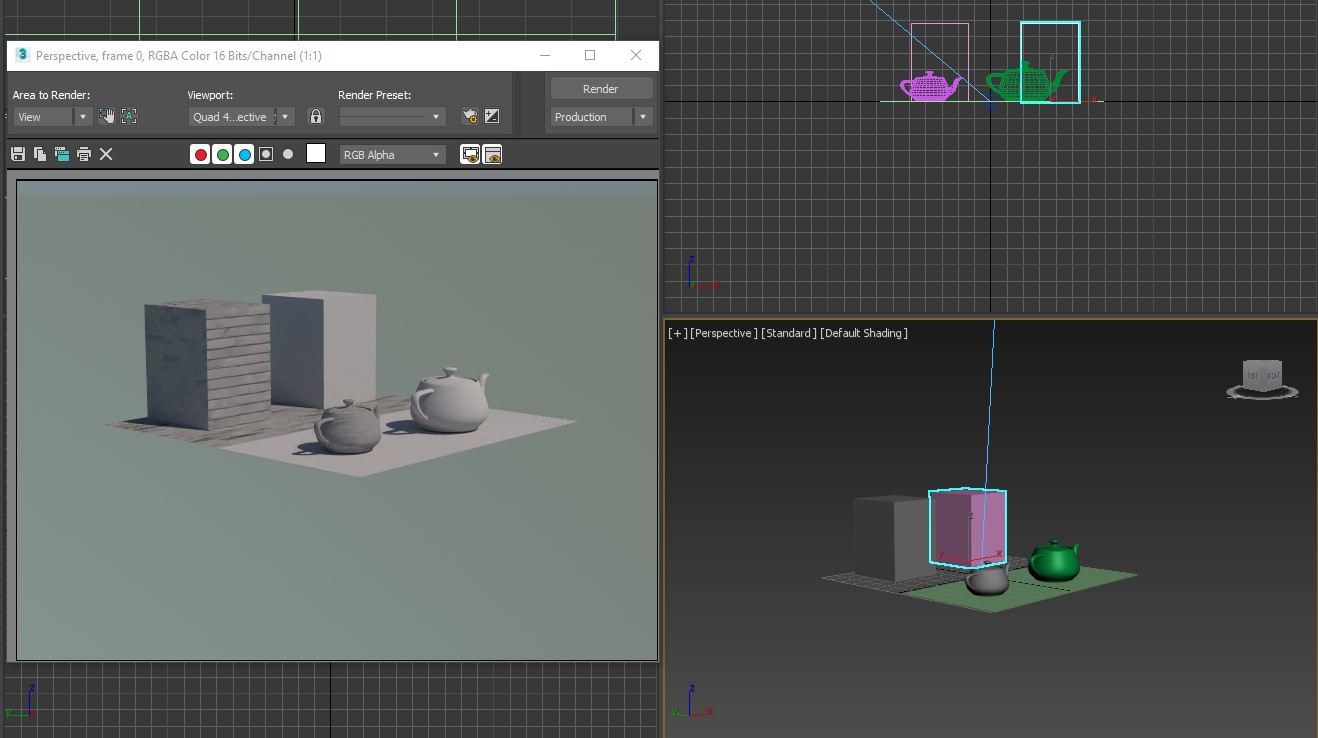

Perspective can be rendered directly and there is no more need to create a camera before hit render.
This is the first step to create RT Renderer inside the viewport.

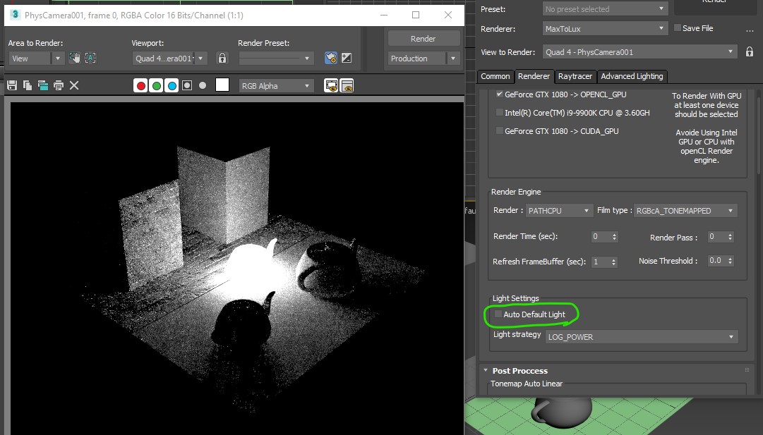

the cornell are rendered both with a Lux point light, because a mesh plane light would have add a lux sky
test scene rendered with a plane with Lux light material. no other lights in the scene, the Lux light material add a lux sky

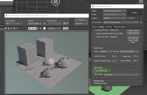

I've already reported through the bug tracker.
It's not a bug. There is an option for it called "Auto default light", you can disable it in the light sitting panel inside renderer settings.
This option will be disabled automatically if there is a light in the scene but mesh lights technically are material light and not lights.
maybe I add auto-detection for that too, but you can disable it simply.
Yes, I did it already, and it renders without adding a sky!

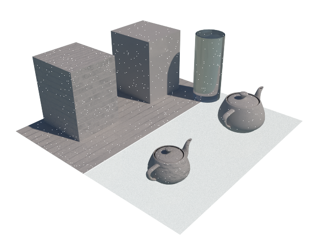

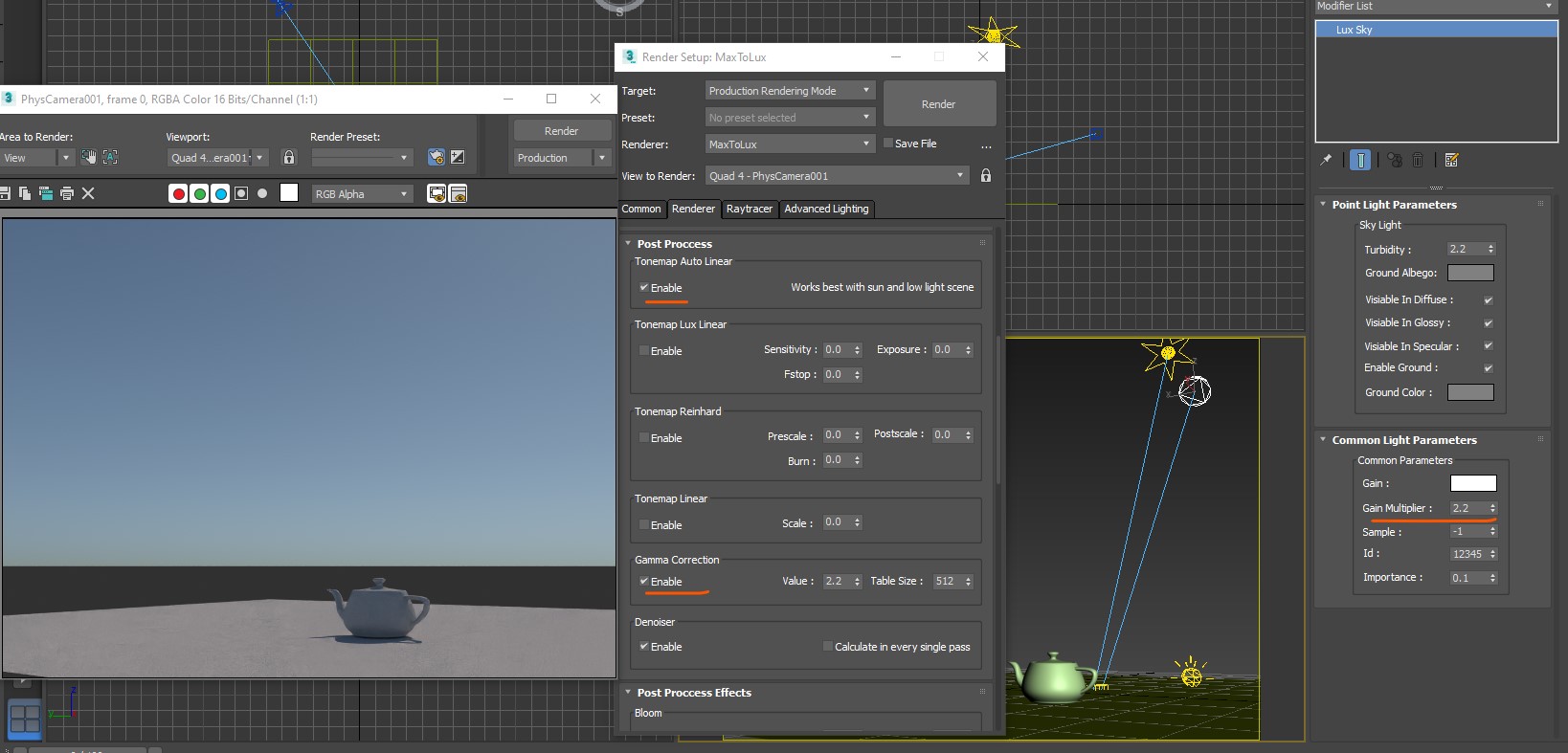

For skylight you need to add a little bit of gain, for example, 2.2 gain multiplayer would be a good number for clear sky, Also use a proper exposer for it like auto linear plus gamma correction 2.2 with 512 samples.
Skylight and/or sunlight are too bright and if you want to see other lights at the same time you need to power or gain.

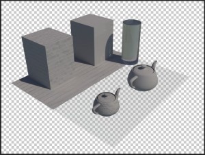

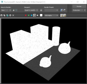

Full VFB support with alpha.
Also, Add support for all file formate.
I can see some black dot inside the alpha channel that will be fixed soon.

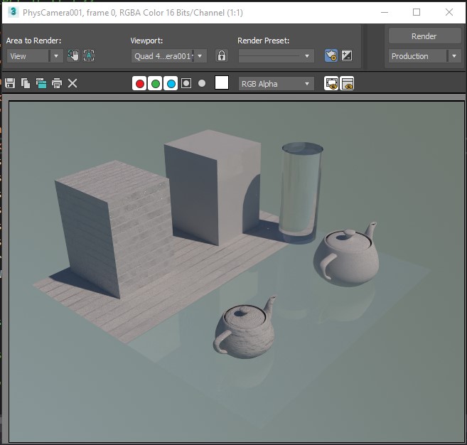

Post by TAO » Thu Jan 21, 2021 11:39 pm
Fixed the alpha black dots.
exr and high dynamic range image are supported, now.
