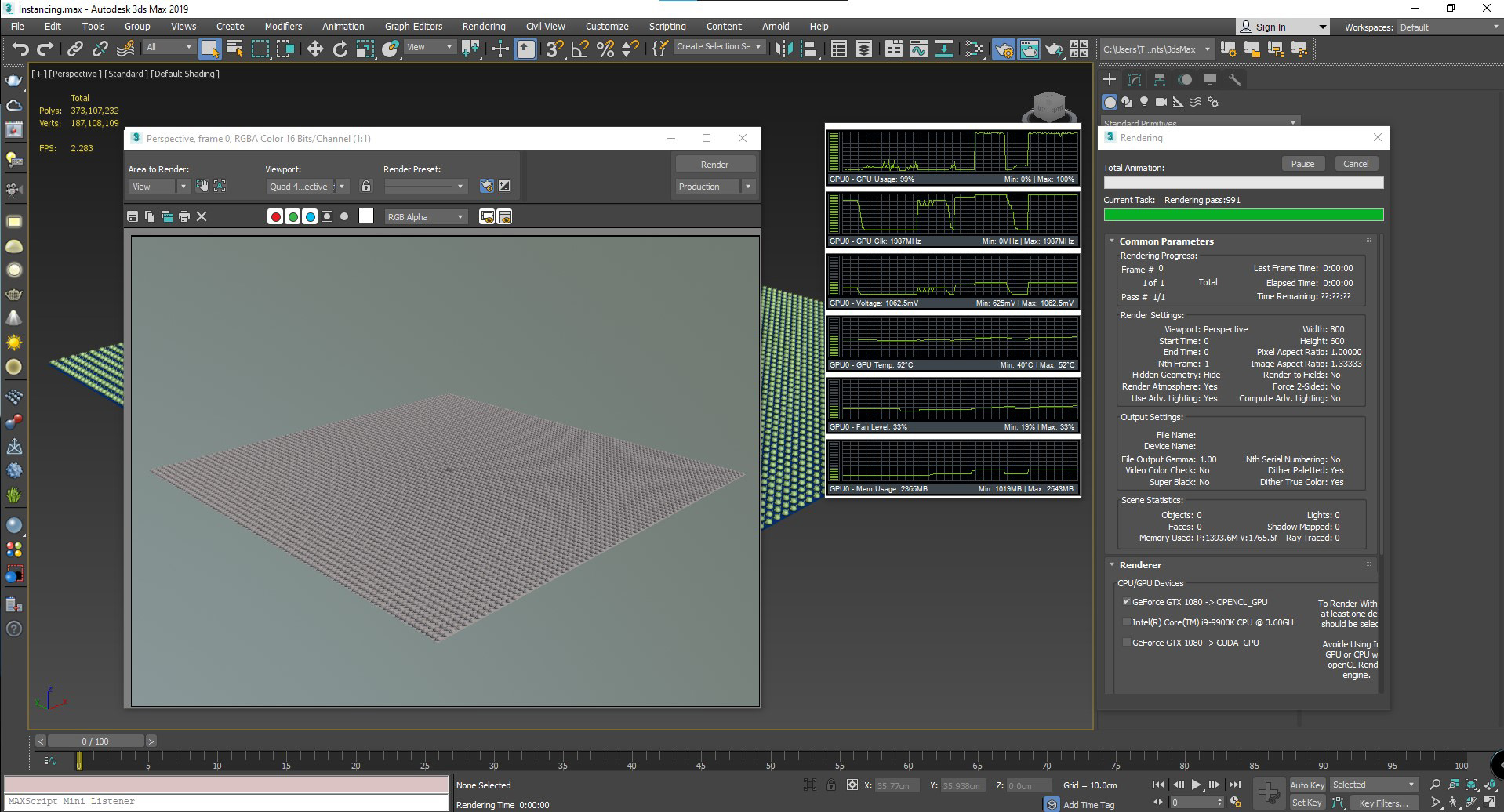

Post by TAO » Tue Mar 02, 2021 11:53 pm
Add support for object instancing for now it is not multi-thread and in huge scenes, with too many instances objects can get a little bit slower than the old algorithm but will offer a huge benefit in memory usage.
If i have enough time i will work on multi-threading and providing a better and faster solution later this month.
The very first look is like this:
All objects are instances and the scene takes almost no memory.
it is a static function yet and i use a loop for it, so it duplicates objects one by one not all at the same time.

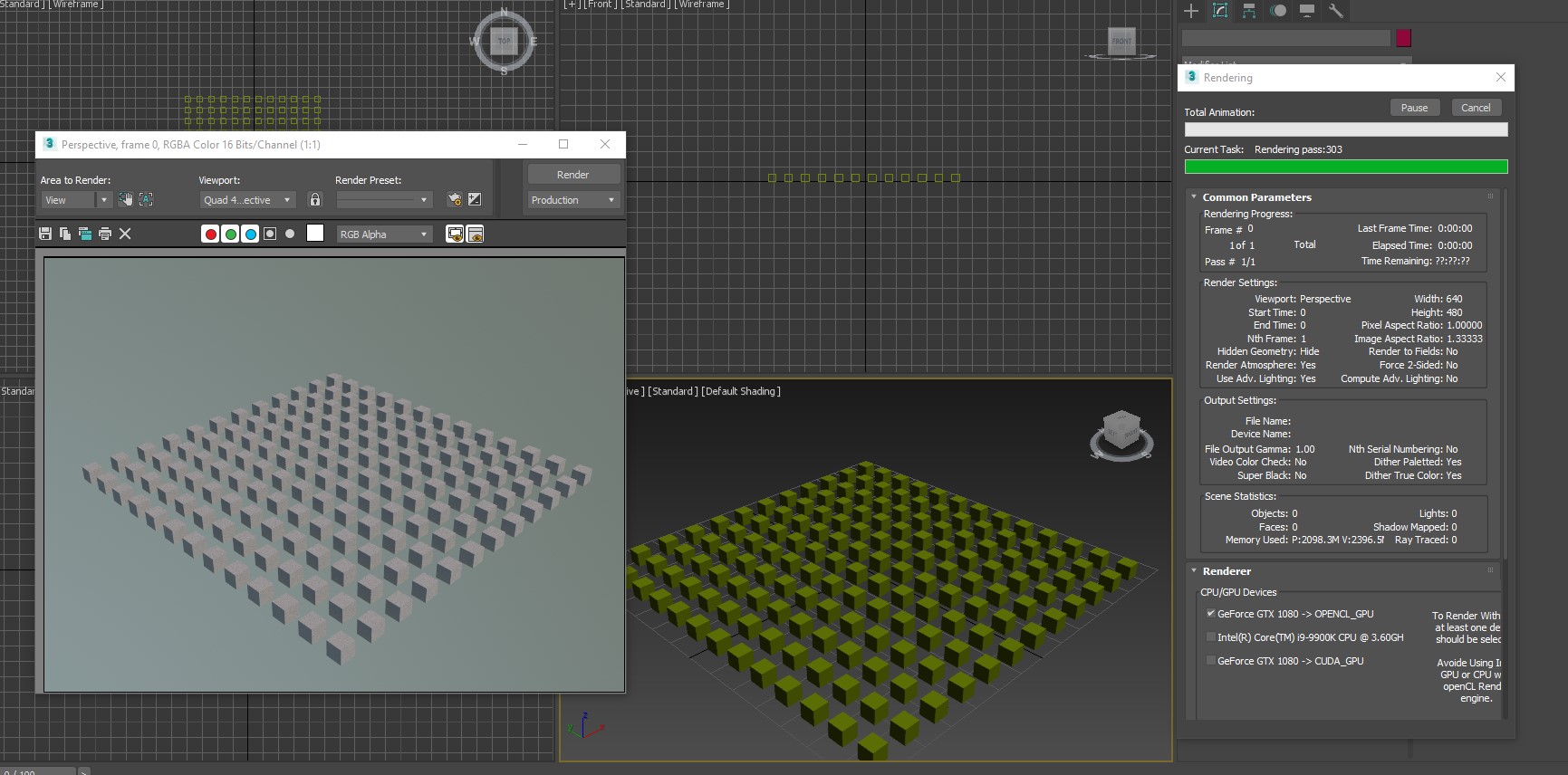

Post by TAO » Thu Mar 04, 2021 6:36 pm
Add support for instancing and references, 12000 teapot with more than 370 million polygons.
Translate time 17 seconds.
GPU memory usage about 1GB
Renderer PathGPU
Render time 55 seconds for 991 passes
The impressive result compares to parsing different mesh, especially in memory usage but a little bit time-consuming in translation part.
I do not know what is the dark color in middle I have seen that before in another render too and it is not about instancing.
Cpu: i9 9900k
GPU: Nvidia GTX 1080
Ram: 32GB
Latest build Download link👇👇
https://forums.luxcorerender.org/viewto ... 590#p30154
