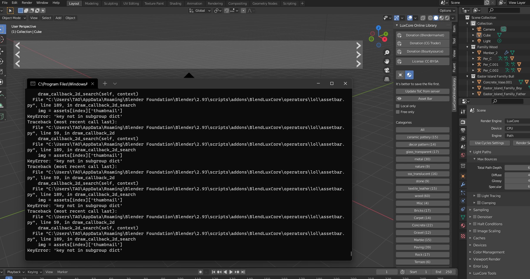

1- If I try to refresh the library from the server after the first attempt the shaders and objects images will not show up anymore unless every time I click on update from the server.
2- sometimes when I try to switch between online and local library blender will stop to respond and I need to close it from the task manager.
3- At the time of receiving the new thumbnail from the server the viewport of the blender is so laggy and sometimes stops responding completely.

TAO wrote: Wed Dec 22, 2021 9:01 pm 1- If I try to refresh the library from the server after the first attempt the shaders and objects images will not show up anymore unless every time I click on update from the server.
Yes, I am aware of that issues and I am working on it.
TAO wrote: Wed Dec 22, 2021 9:01 pm 2- sometimes when I try to switch between online and local library blender will stop to respond and I need to close it from the task manager.
I have to check if I can track that down.
