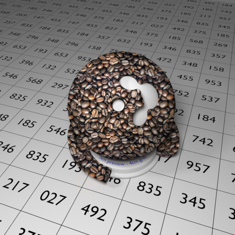

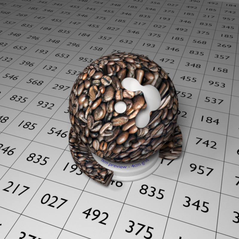

I added the support for camera projection UV shape. The UV of a mesh can be computed with the following syntax:
scene.shapes.obj_shell_src.type = mesh
scene.shapes.obj_shell_src.ply = scenes/luxball/luxball-shell.ply
scene.shapes.obj_shell.type = cameraprojuv
scene.shapes.obj_shell.source = obj_shell_src
scene.shapes.obj_shell.uvindex = 0
This is a normal UV rendering:
And this is a mera projection UV rendering:
Note: the UVs are (pre-)computed at vertices so UV interpolation is done in screen space and not in world space. This means large triangles can introduce texture image deformation.

Bake has no rendering cost: back projecting the point for each ray intersection with such material/texture is far more expansive. The draw back is the one I explained in my note.
BTW, actually, it is possible to use multiple cameras: you create the object with Cam1, than edit the scene to redefine the camera as Cam2 and you will obtain the desired result. The object is backed with Cam1 but the rendering will use Cam2.
