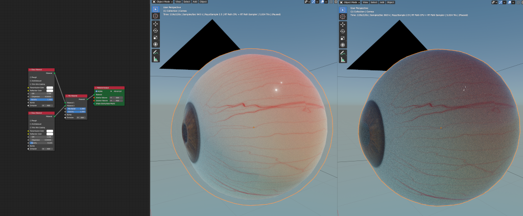

I'm trying to make an eye shader. The cornea needs to be clear, and it needs to refract the iris. This is giving me headaches. I'm using a glass shader for the out shell with the cornea on it. If is set the glass shader with an opacity of 1, the refraction works great but the eyeball gets dark. If I decrease the opacity of the glass, the eyeball returns to it's normal color but the refraction goes away. I realize glass will always impart some color, but I'm hoping there's a way to minimize it as it's quite strong. I've attached an image that shows the simple switch I created to go between the two shaders and the output both create.

Try to set the shadow color of the outer shell to white (this setting is in the advanced options in the output node).

Thank you! That did indeed work.
