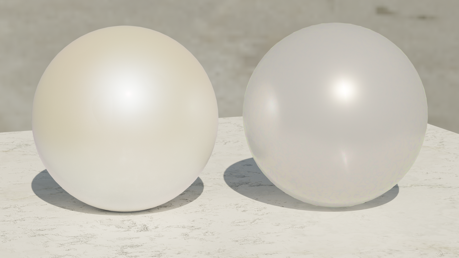

josephmcs
Posts: 30
Joined: Mon Feb 01, 2021 7:02 am
Re: Pearl material
Post by josephmcs »
Cool! Thank you.
I put the two of them side by side for a little test if anybody is curious. Mine is on left, yours on right. Nice to see the different approaches together. I think my version of yours could use some tweaking on the noise size, but I like it.
Posts: 810
Re: Pearl material
True, depending on the size of geo, noise and volume must be tweaked.
For study I use MaterialX shaderball (.../resources/geometry/) @ 20cm in diameter.
