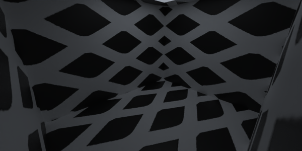

I have a problem with background image. It looks absolutely normal, but LuxCore doesn't like it. I've done tests with few scenes. In the attachment you will find the most simple scene I could create. It is a box. Inside a box I have a light source. I have a camera inside the box. So from theoretical point of view, as I'm inside closed space the environment should not change anything.

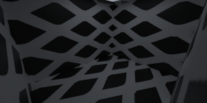

Without background image the render looks like this:
But when I set this texture as background the render is completely black, no matter how strong is the emitter. With some scenes I get segmentation fault. So in 100% the problem is with texture but I want to know why to not repeat the problem in the future.

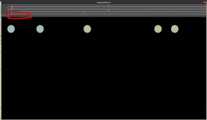

The problem is triggered by the broken/corrupted HDR used for your infinite light source:
As you see, it is full of NaN values. This cause a cascade of problems: building the importance sampling map will go horrible wrong, power base light strategy will not work, etc.

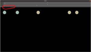

You original image doesn't have NaNs but have negative values:
It is still stuff a light source can not emit. Use exrtools (i.e. exrdisplay in this case) to check .exr files; it is the reference ILM OpenEXR implementation.
