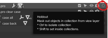

Since there is now holdout material option in luxcore, can we get this button working?
Or is there another way to do this for luxcore?
It's an override in blender to make whole collection into a holdout. To make several object into a holdout I would now have to go through each object and their materials to turn this on/off....holdout collection override

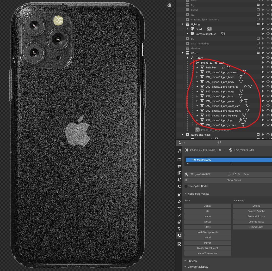

Here
It is in a clear case, now if I want to make phone into a holdout every material within every object has to be enabled and disabled manually. And even if the object had holdout flag I would have 13 of them to do manually. (but in that case I think Simon would have much less work to make collection holdout working)
iPhone model has 13 objects, some use multiple materials.
