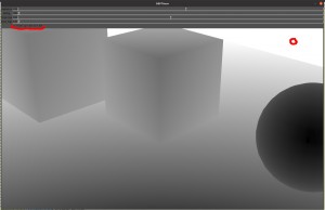

Sorry,
still do not understand why the same scene rendered in blender, and than exported and rendered with standalone give different results.
Exr use 16 bits but still infinity should be infinity or not?
I attach my scene. What should I do to get the sky white?
Z-pass depth map

Hi, could somebody take a look at this problem?
Re: Z-pass depth map
The DEPTH.exr file shows INF values as expected

Thanks Dade,
I have solved this issue. When you open this image with gimp it gives black color for INF values what was confusing. I've been trying to open this file with openEXR library but I made a mistake. I was not opening the original image but compressed. And this is what I have found. If I open exr image and save it using lossy compression like DWAB, all INF values are LOST!
