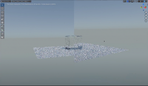

Here's a very basic example showing LuxCore and Cycles
LuxCore
https://drive.google.com/file/d/1KbRYRK ... sp=sharing
Cycles
https://drive.google.com/file/d/1FE5p9d ... sp=sharing
Both video have been recorded with the same conditions, meaning the same apps running in the background (mostly OS services/utilities).
3D Designer, Photographer
https://phoenixart.com
Re: Performance issues
Weird, this horizontal division is something I've never seen before.
B.Y.O.B. wrote: Sat Aug 29, 2020 10:53 am Weird, this horizontal division is something I've never seen before.
They are the GPUs tiles, he has 2xGPU.
Ah, right, I didn't remember that RTPathOCL can use multiple GPUs.

I tried with CPU only and the split-screen effect is gone. The performance hasn't improved much, though
The same happens using 1 GPU only, no split-screen, and performance is just about the same.
Here's a screen capture
https://drive.google.com/file/d/1u7wDf5 ... sp=sharing
