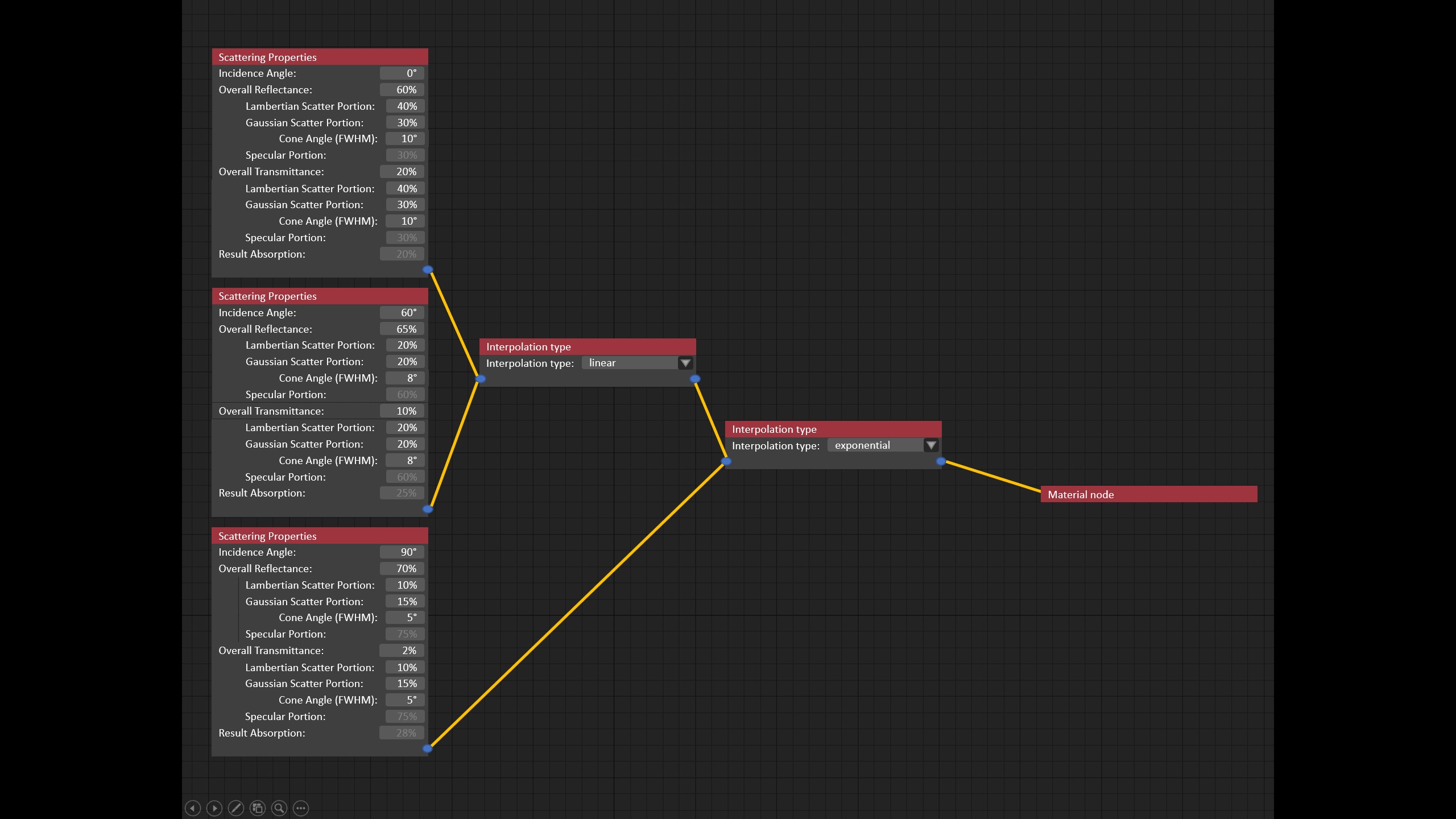

Might be the right time to introduce kind of brdf node that allows to define the portion of scattering types (matte, glossy, specular) per incidence angle. Ideally with some optional interpolation types (e.g. linear, exponential etc) between those points.
What do you think?
