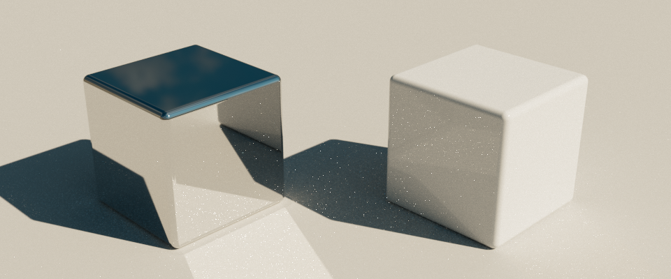

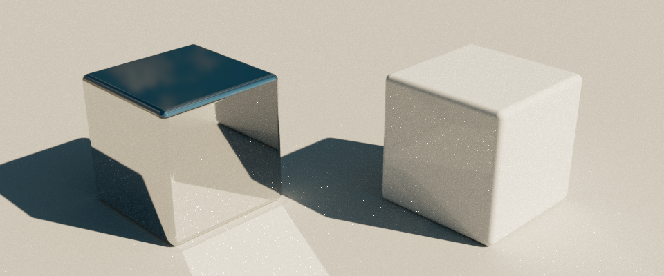

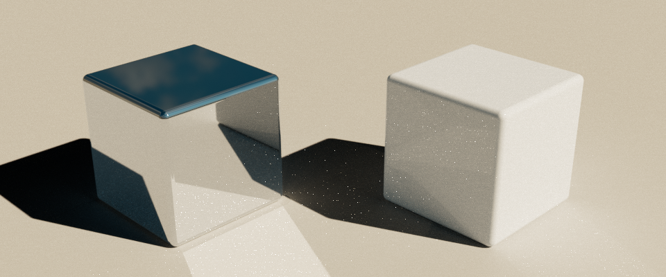

When using a HDRi with light tracing, it looks like the shadows are a lot darker, as if only the sun is used in the image. This seems to only happen when using OpenCL, CPU looks as it should.
There are also a lot of fireflies in this scene, not sure why as caustic paths should be accounted for with the cache.

Light Rays was set to 100% using OpenCL, the 2% was only on CPU rendering (which had the correct result).

Just to clarify what the issue is here, the CPU image looks as it should, but the OpenCL image has the shadows much darker. The Light Tracing % was set to 100% for OpenCL, and set to 2% for CPU. I only set it to 2% as I didn't need the default 20% as the caustics would get clear much faster than the rest of the scene
