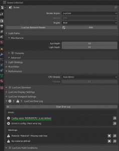

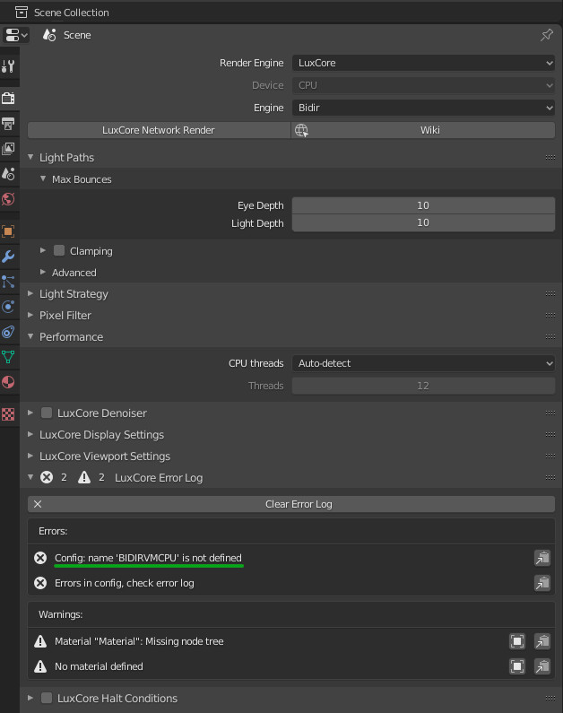

and got :

Re: Bidirvm
Try putting "BIDIRVMCPU" in quotation marks. Otherwise Python will interpret it as a variable.

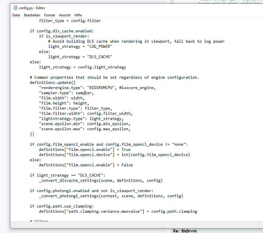

Re: Bidirvm
Did you copy/paste the code from here in the forum into the code file? Make sure that you keep the indentation (i.e. white spaces at the beginning of each line), didn't forget the comma between "BIDIRVMCPU" and the hash-symbol, or the brackets at the end.

Re: Bidirvm
here is how it looks in a text editor
Re: Bidirvm
# Common properties that should be set regardless of engine configuration.
        definitions.update({
            "renderengine.type": "BIDIRVMCPU",#luxcore_engine,
            "sampler.type": sampler,
            "film.width": width,
            "film.height": height,
            "film.filter.type": filter_type,
            "film.filter.width": config.filter_width,
            "lightstrategy.type": light_strategy,
            "scene.epsilon.min": config.min_epsilon,
            "scene.epsilon.max": config.max_epsilon,
Thanks a lot it is working Now ! ;)
