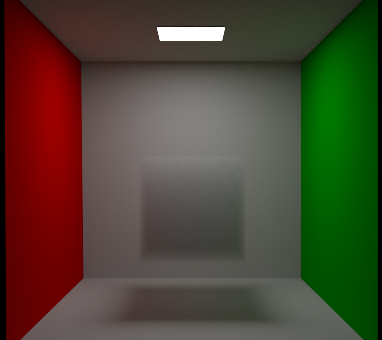

Directly, I want to know how to describe homogeneous media in LuxCore SDL.
For example, in the scene file posted earlier, the cube will not be homogenous media and will be drawn in black.
Re: AeroGel-like object
You should use NULL material (not glass) so the surface is totally transparent than define an interior volume, you have defined only the exterior but not the interior.minimal_surface wrote: Sat Feb 15, 2020 1:13 pm I also looked at how to use Blender.
Something like: https://github.com/LuxCoreRender/LuxCor ... losion.scn (you need to download the referred .vdb from sample models of https://www.openvdb.org/download/ or to replace the heterogeneous volume with an homogeneous one).

I did not know that there are abundant samples in the LuxCore directory.
Finally, I reached the point while comparing the meaning of the words in the explanation with the drawing results.
I would like to enjoy customization, thank you. scene.camera.lookat = -1390.0 -4000. 1365.0 -1390.0 1000. 1365.0
