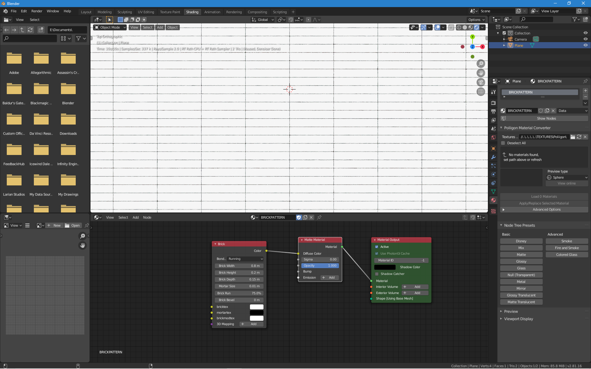

Trying to create a brick pattern with each row shifted a bit. I assumed the brick run parameter was used for this, but it does not seem to do anything (see attached image). Am I missing something?
Blender version: 2.81a
Blendluxcore: 2.3beta1
Brick texture

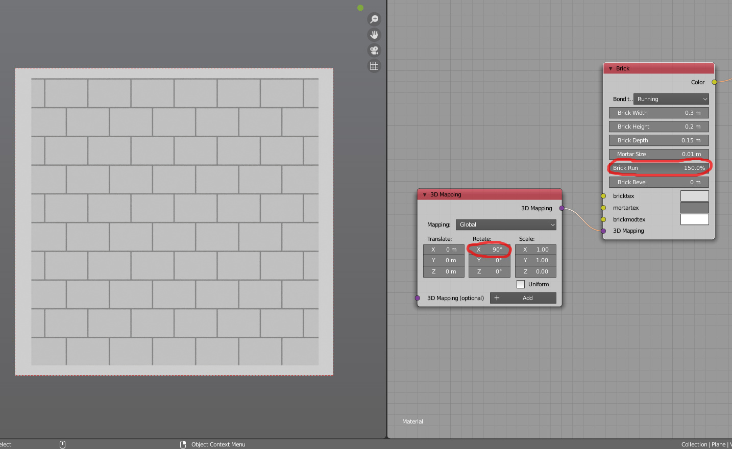

Add a 3D mapping node, rotate x 90 degrees, in brick node play with the brick run value for example 150%.

That worked beautifully. Thank you for the tip!
