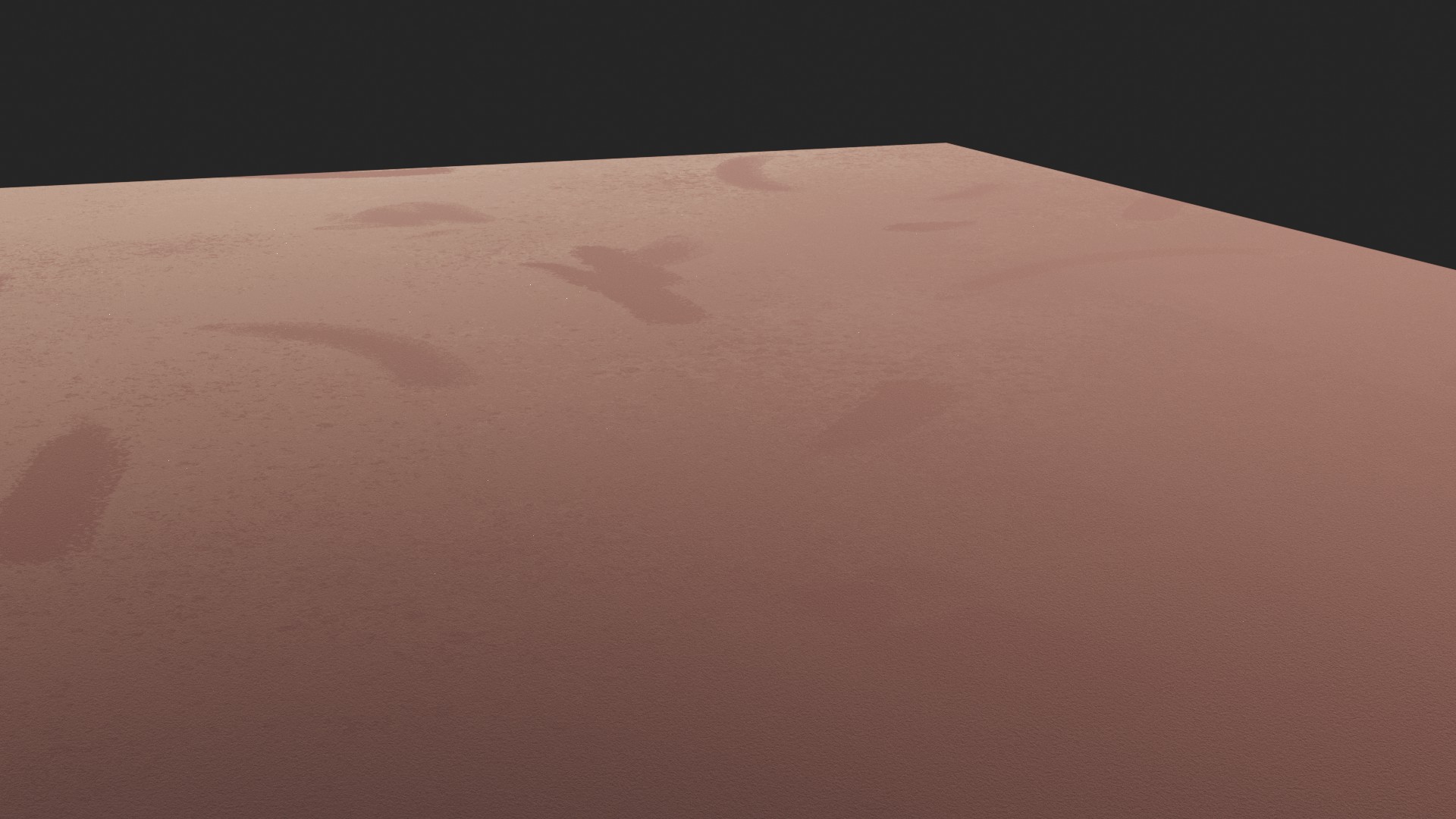

Sharlybg wrote: Fri Sep 11, 2020 3:50 pm I'm talking about bump at micro level but large scale irregularity. But you say a close look at it doesn't look like displacement or bump at all. It is more like textured surface :
Yeah those circled areas are where the fibers go the other direction. There is no bump or displacement involved in that short of what you need to get the anisotropic effect and create some fiber length irregularities. The size of texture you would need to get the effect on a large floor likethis would be ridiculous. You would need 16k or larger to get a good result out of this since it is a floor and covers a much larger area. This, again, is why I want anisotropic rotation because you could use a basic 8k bump for it and then use the anisotropic rotation map to define the patches which will have light bending the other ways in a 4k 16 bit tif file. Boom, boom, done. Unfortunately still missing some functionality to make that happen.

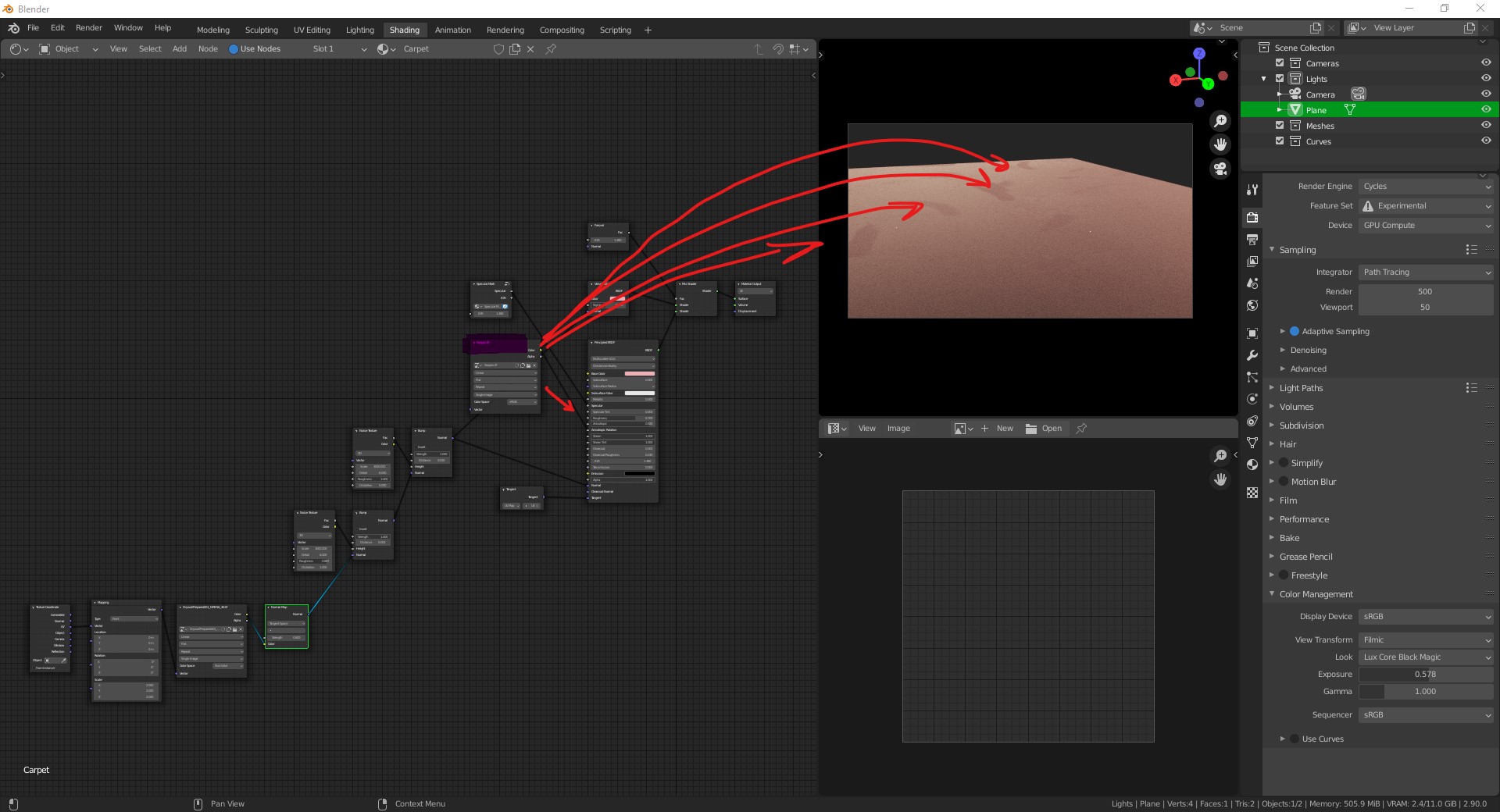

What I would do in a perfect world is this. I would load of the floor plane, Load up a patchy velvet albedo, if it is new, there won’t be much variation in the surface color because the albedo value should all be the same amount of light being reflected back for everything but there would likely be some slight patchiness to it still from natural imperfections in the fabric color. Use a very basic velvet bump and plug all that into a velvet material. At this point I am not worrying about the hair brushing in different directions. Once all that is right, only then I would load up a glossy material with multi scatter and anisotropic roughness. I would make my rotation map using flood fill in substance with occasional random island values. Plug that into the rotation amount and then blend the glossy and velvet using fresnel. I would make sure the bump is on the glossy as well and that would produce the result you see in his question. You need more than just a bump to get this result.
Here is an example of how the final result might look if we had acccess to anisotropic rotation in lux yet. This is my preffered way of adding brushed marks in surfaces, as well as micro-scratches. In the below image the bump nodes are a series of noise textures set to 3000 and 5000 just to add some roughness that wont get cleaned up in sampling, along with one larger image texture that ads some large wringles across the hole floor. I used one I already had so it doesn't exactly match the smaller micro qrinkles in the reference but it gives a decent idea of how tall it should be at only a few mm tall. Then I used a rotation map that guides the anisotropy in a different direction and here is the result. This is just a quick example that I threw together in like 10 minutes with photoshop. For a final I would do a lot more work in substance to get everything perfect but I am hoping it will get the idea across and also maybe highlight the value of rotation maps which are not yet available in luxcore sadly.
