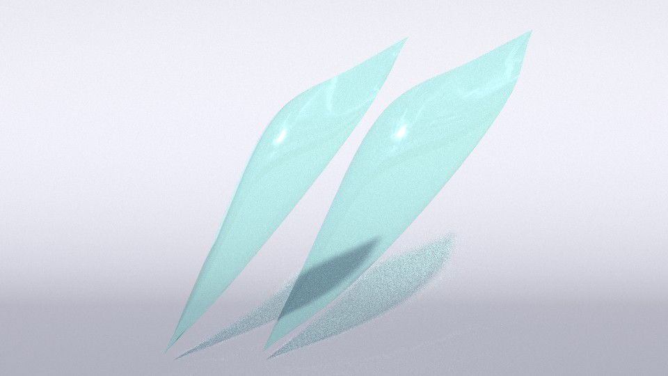

Yes, here's result w/ biDir.
Check attached .blend and compare. Or send yours.

Unfortunately i can only share the luxcore files.
Anyway i imported your file and created a new scene and now it works... very strange. I do not understand. Same scene, same material....

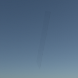

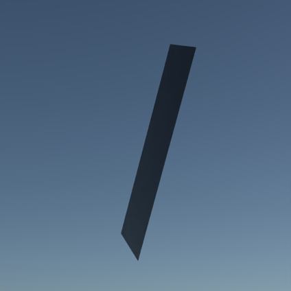

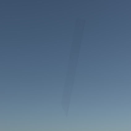

But what about the simple plane scene i posted where the same plane suddently renders almost black?

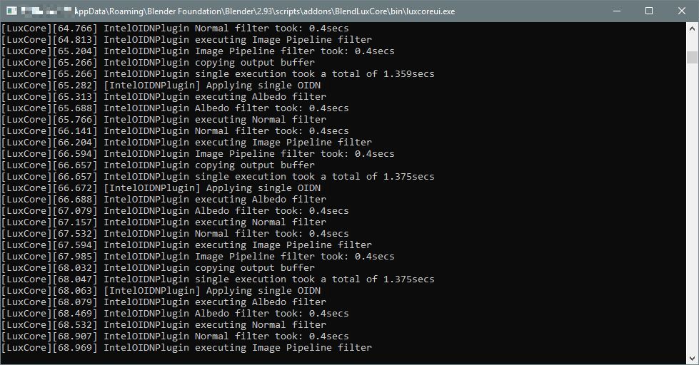

Your files render same as you've shown, but differently tonemaped & crash when I want to save outputs.daros wrote: Wed Sep 08, 2021 5:51 am But what about the simple plane scene i posted where the same plane suddently renders almost black?
Also go into an endless loop, and when paused it still continues... denoising...

Anyway this two scenes should be really identical, only the camera angle varies. Why one shows up black and the other transparent? How is that possible? May Dade can help me with this?

It is a numerical precision problem (see viewtopic.php?f=4&t=3829&p=31635#p31627). You are rendering something 300m away from the origin with a thickness of few mm.
This is the distance between two consecutive hits in a path (first number is the path depth, second is the distance):
As you see, the first hit is after 38m, the second is after 3cm and than the path is stuck there, self-intersecting the same point. The max. path depth set to 256 is also absurd but that is a different matter.
If you set the epsilon to a more appropriate value for your huge scene size, it will render fine:
scene.epsilon.min = 0.001
scene.epsilon.max = 0.001
