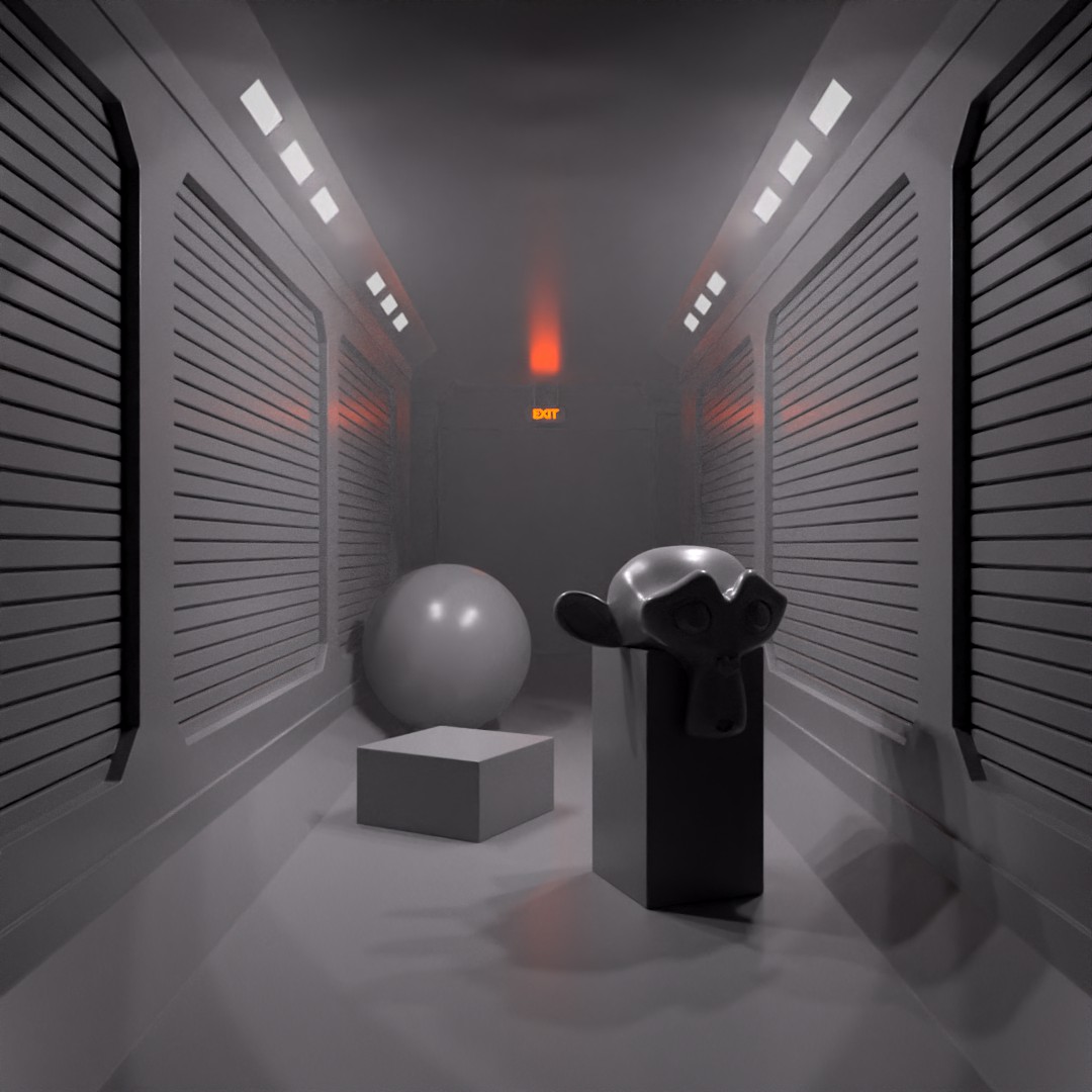

I´ve tried to make fog effect in my scene, but no success. I used this Dravia video (https://youtu.be/gvo9WLBqNVU) as a guide, but I can´t see the effect.
I´m running Lux 2.5 Daily Built from January 19th on Blender 2.91.
Scene attached.
Thanks,
Mist Luxcore.blend
(1.36 MiB) Downloaded 845 times

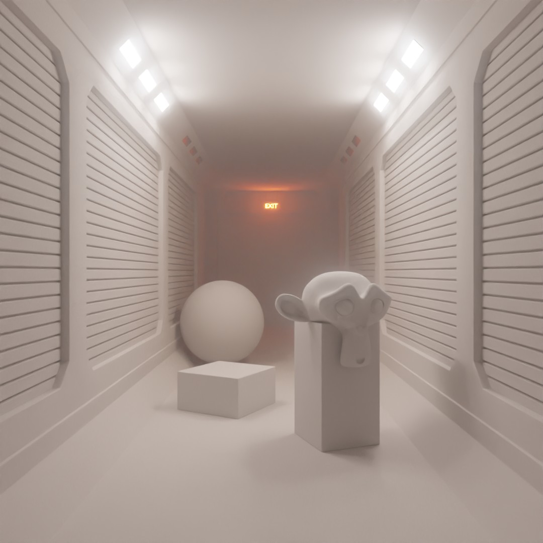

Here:
Note, Fog's Interior Volume is Corridor's Exterior Volume.
Take care :)
Mistiqlc.blend
(1.44 MiB) Downloaded 911 times

@kintuX, I noted that you used a valor of 5 for priority, on Heterogenous Volume node. What is it for?
Posts: 822
Re: Trying to make fog effect
Leandro Oliveira wrote: Mon Jan 25, 2021 11:44 pm @kintuX, I noted that you used a valor of 5 for priority, on Heterogenous Volume node. What is it for?
From documentation:
Volume Priority
Volumes have a priority setting, which is an integer number.
In regions where volumes overlap, the volume with highest priority is chosen and replaces all other volumes.
https://wiki.luxcorerender.org/LuxCoreR ... e_Priority

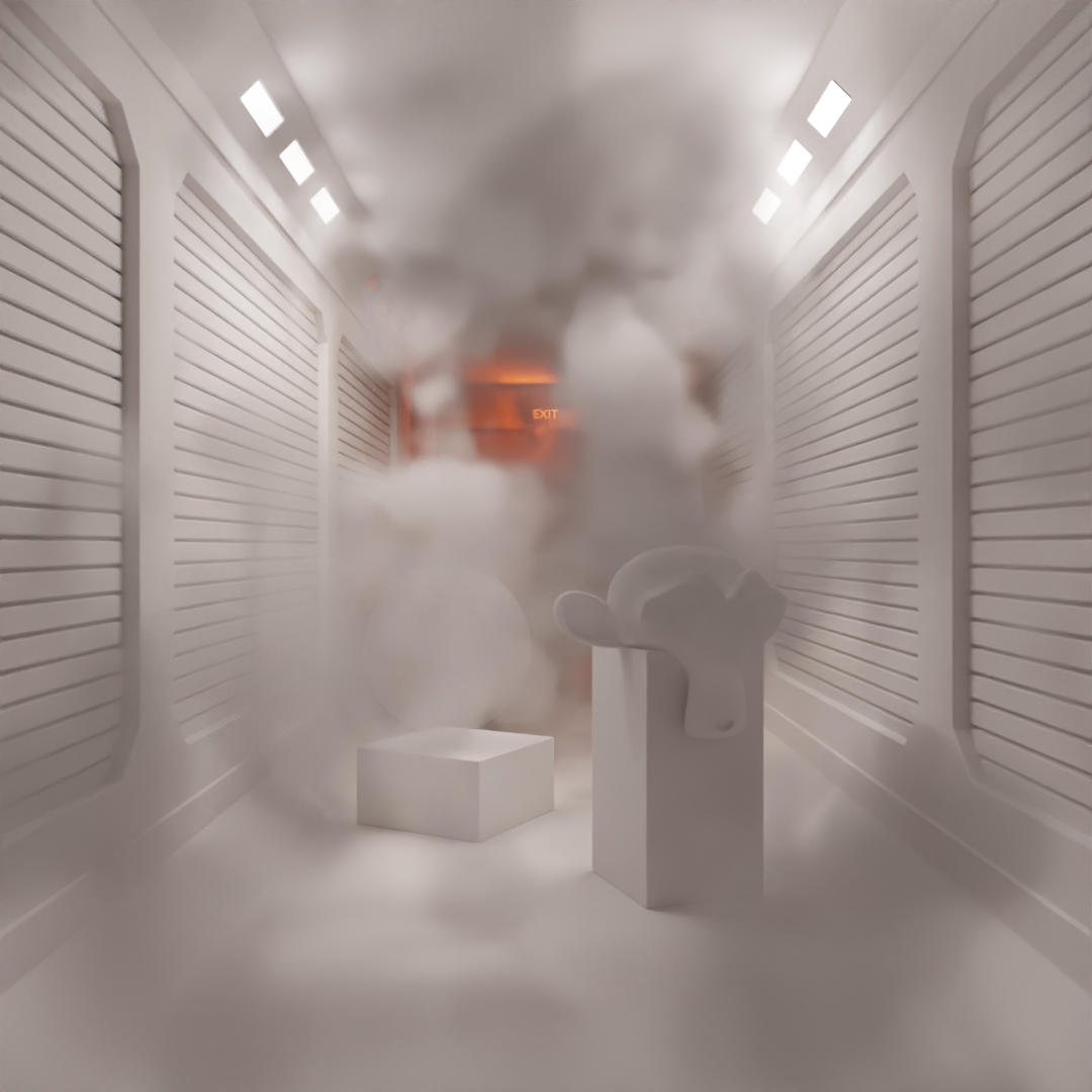

Hey, Leandro. You can also check this file with simple homo- and heterogen volume.
Mist Luxcore.blend
(1.4 MiB) Downloaded 847 times

Pay your attention to Camera's volume auto-detect. With premade volumes no need in Fog object. But in example from @kintuX Camera volume autodetects happens from Corridor exterior volume(because it have only inner normals direction).
