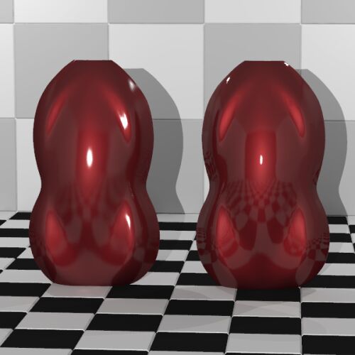

Figure 17: Two automotive shells with 20 degree specular gloss of 10 and 60
Source of image: additional images

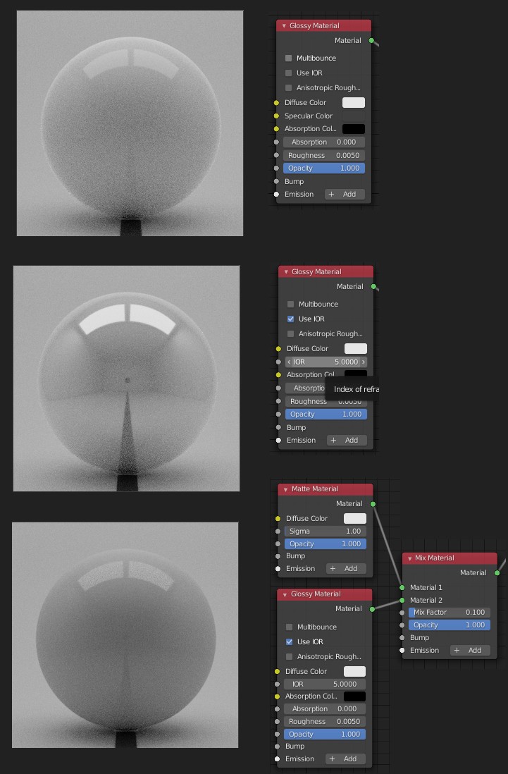

Hi Daros, your material-testing setup is great ! Happy to see you here, I remember your quality works from Maxwell days :)
The fringe looks like it could be IOR related. Not sure how it is taken in account by the various shaders. Mixing a Matte and Glossy material seems to provide better control over reflection falloff, even if the result is quite dark. Sorry for the bad quality/convergence renders, my system is limited 3d-wise :D
[Edit:]
To try and get more light, here's a test with more bounces, and Diffuse shader's diffuse color with color value=1.2 (living dangerously :lol: ), not sure it is taken in account. Maxwell had an "additive" mix shader I think, that could be used to add a glossy layer without loosing light.

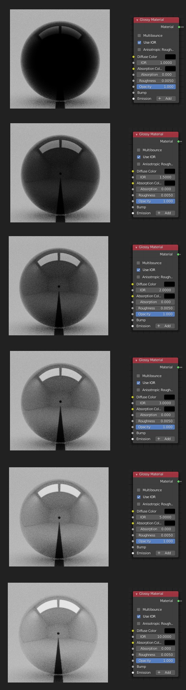

daros wrote: Fri Nov 27, 2020 1:33 pm The mixer test would be perfect if you would be allowed to use a fresnel function to blend the nodes. It cannot be a constant value (like it is in maxwell after version alpha) but a value which varies accordingly to the incidence angle.
It is pure non technical speculation, but as I understand :
  • IOR controls the fresnel faloff
  • mix shader normalizes reflected light between the two shaders
If this is true and I understand what you are explaining, playing with IOR and mix factor acts as a fresnel blend.
Here is a test with different IOR values for a glossy with black diffuse to see better the effect :
Higher the IOR and "flatter" are the reflections. However looking up for IOR references, IORs above 3 seem pretty rare, so it might not be physically sound to use it like this.
