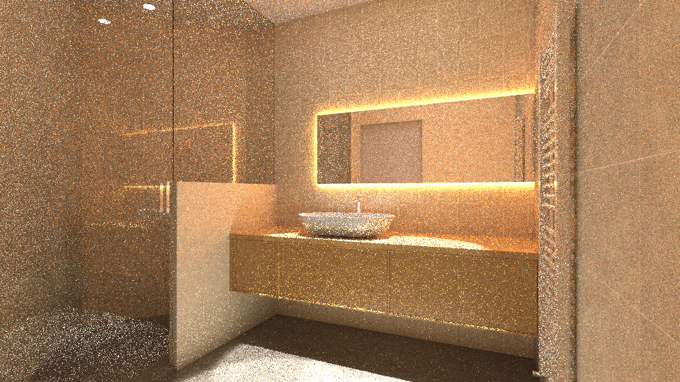

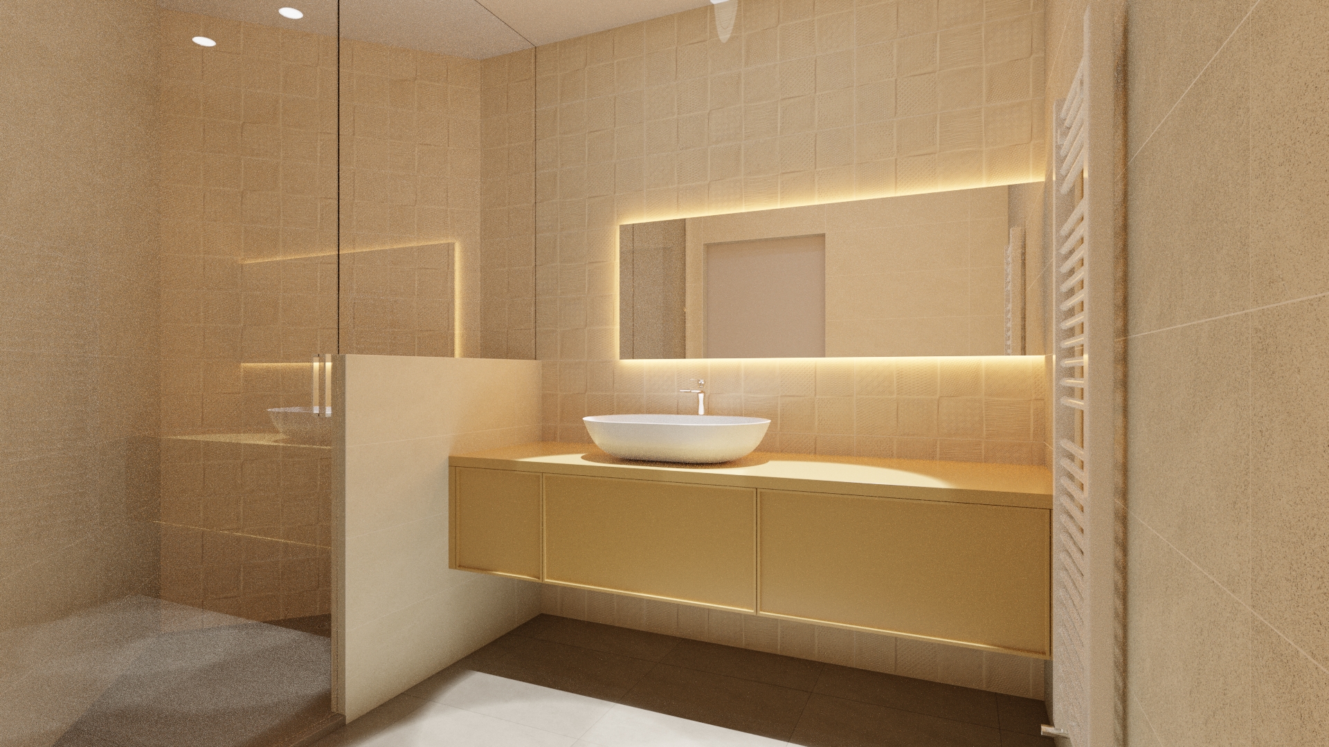

This is a sample from the above file, 3600 samples.
Look at the glass zone on the left, it is noiser than the right one. Also, look at the lower left side, where the floor reflection is, which is really undersampled.
So, when it gets denoised, left side is too much blurry, specially the floor reflection (white area).
Regards

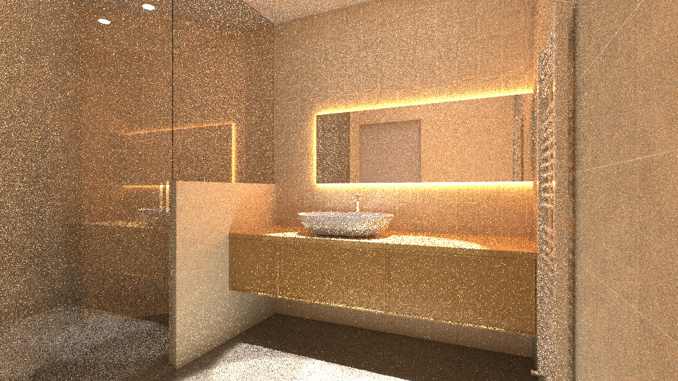

I have looked into this scene and the problem is that glass reflection is really under sampled. In this case, the reflection is sampled only in 3%-10% of the cases.
I added a cap (25% and 75%) to (Arch)Glass transmission/reflection sampling in order to work around this problem. The cap is a bit arbitrary (but I don't see a better solution at the moment).
This was a 100 samples/pixel before:
and now:
This should help.
However there is also a denoiser problem on glass that is out of our control. A work around could be to render the image at higher resolution, denoise and than scale down (may be also mixing a raw and denoised image).

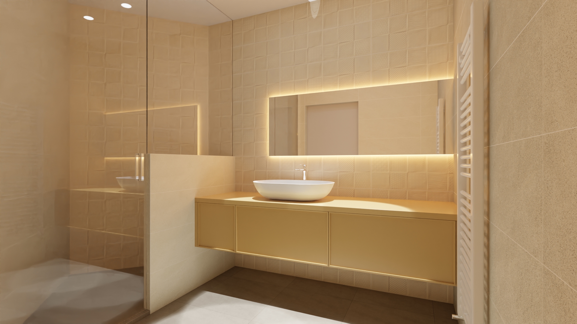

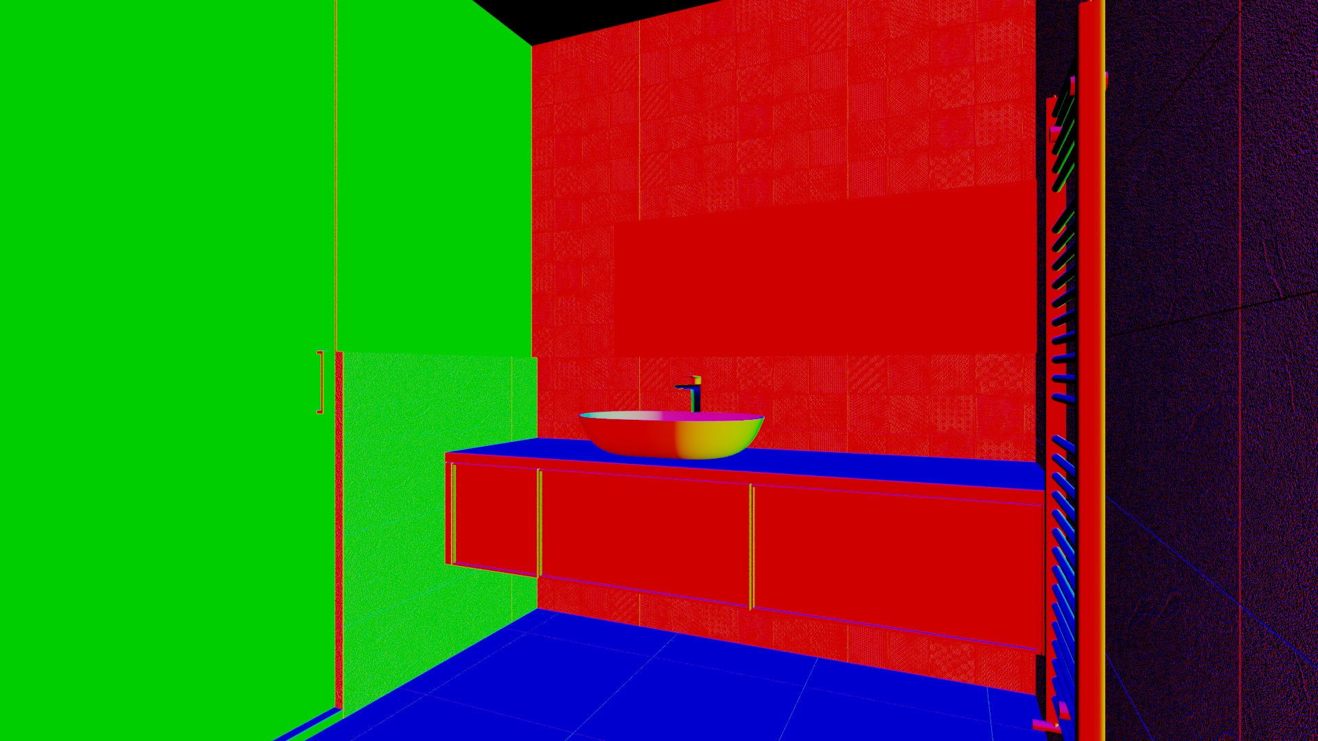

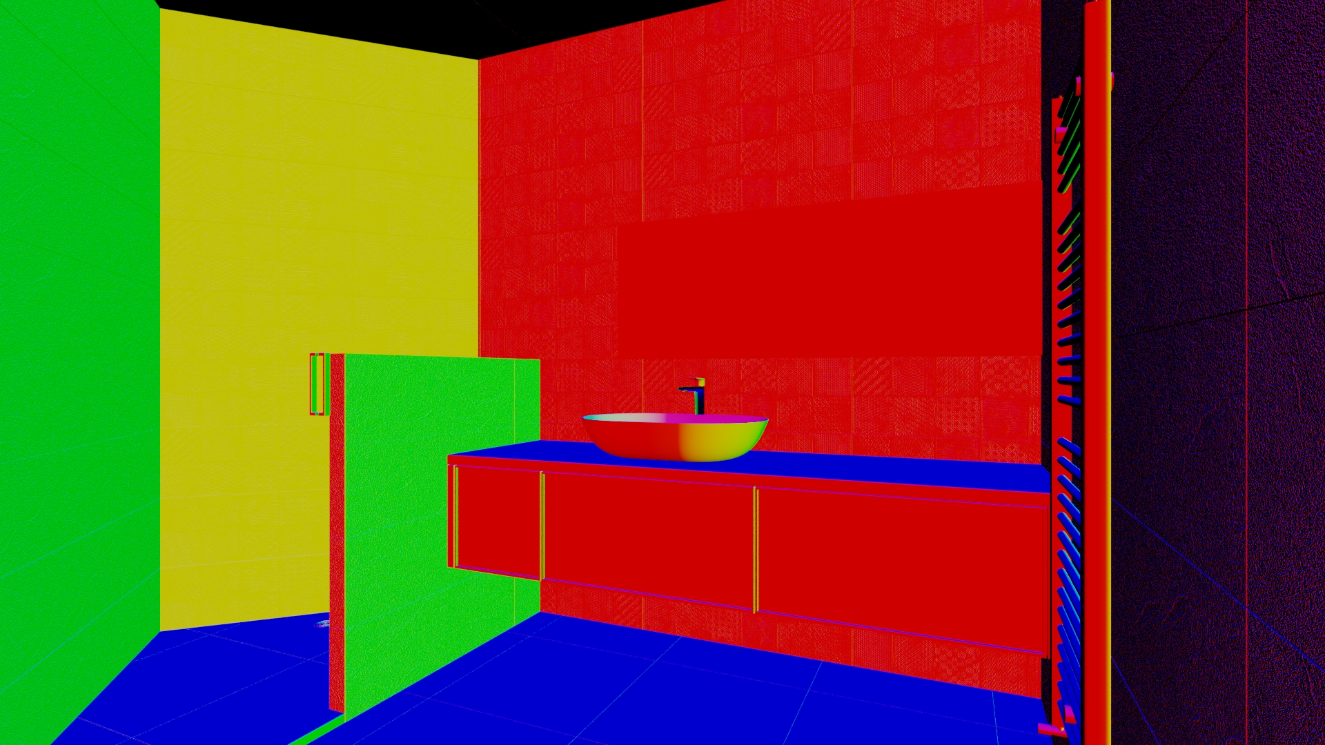

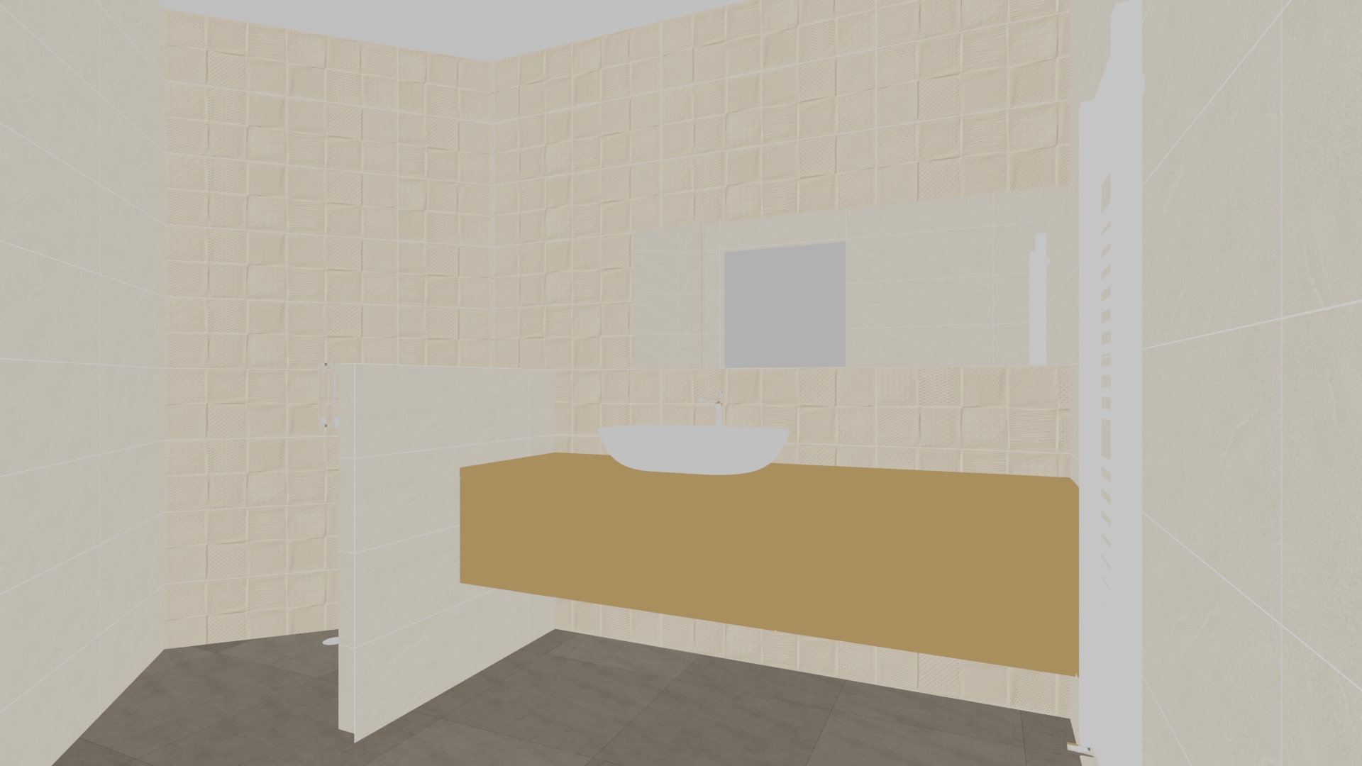

Well, I've managed to achieve something.

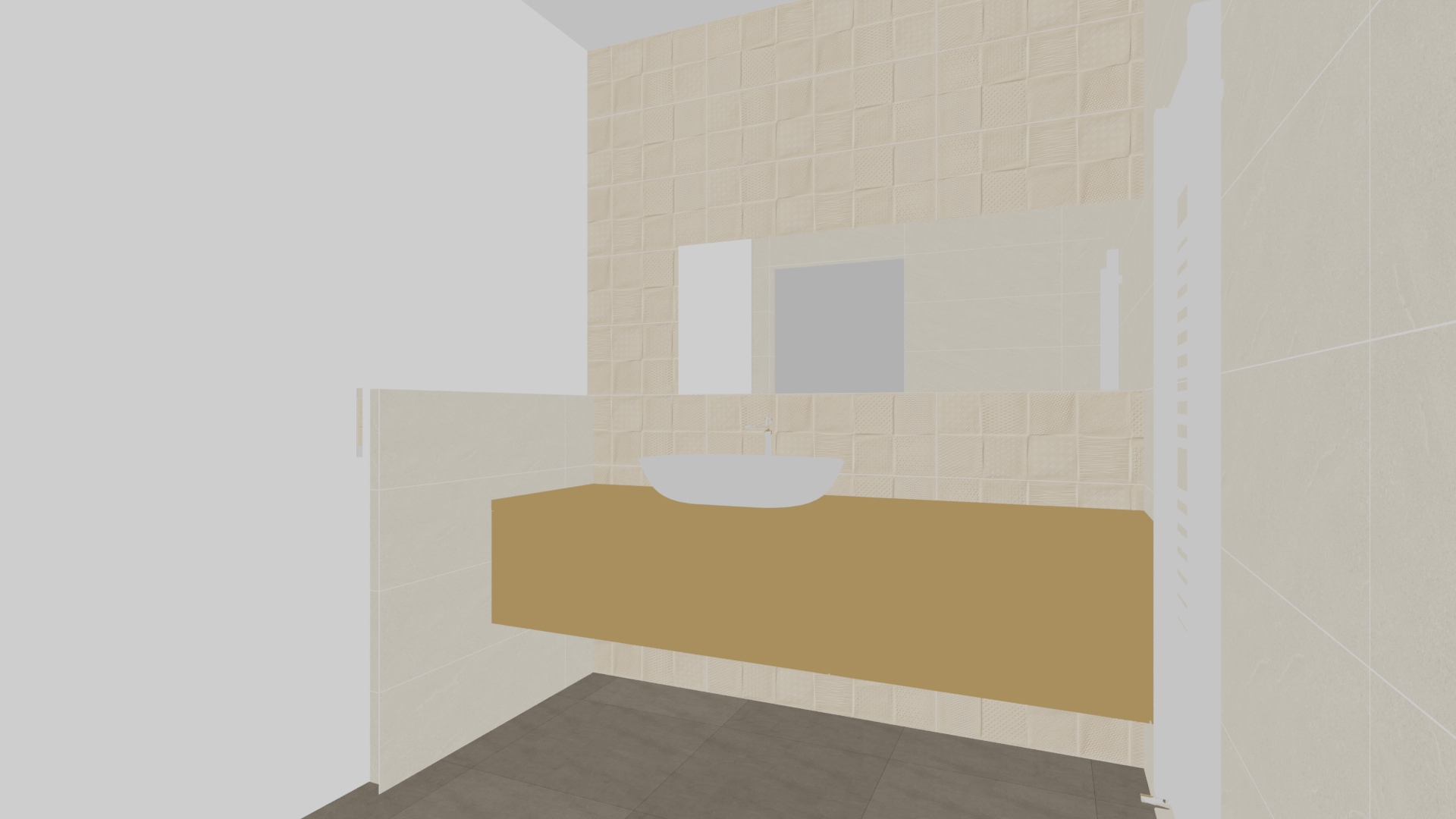

This is original denoised image given a number of samples, with the albedo and normal pass:

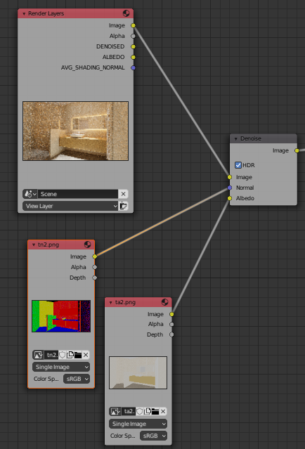

But Setting opacity of the glass to 0 and render with few samples to get the passes:

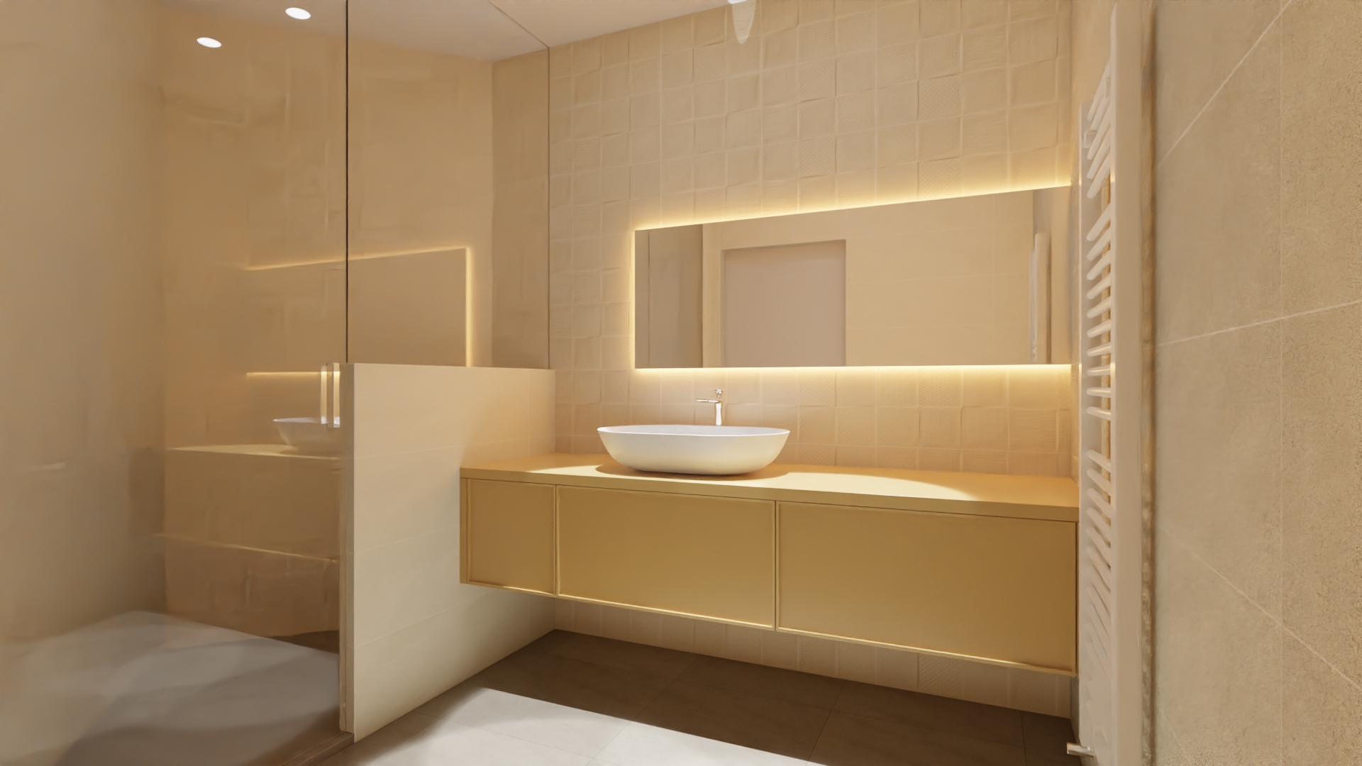

Denoising the first noisy render with these other passes we get a much better image:
So, what I suggest is to have the option to disable the glass from the normal and albedo passes, on the material.
