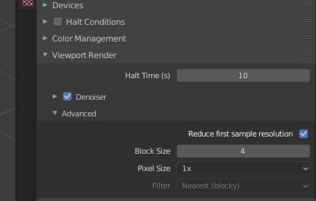

Go on this panel setting:
and change the block size to something like 32. It should be a lot more responsive.

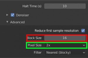

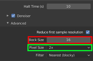

The root of the problem is the initial RTPATH setting for resolution: it is clear from the video that Cycles start rendering with blocks large as about 32x32 while Lux uses 4x4 (1 samples every 32x32 pixels Vs 1 samples every 4x4 pixels). Indeed, 4x4 isn't viable for full screen view port renderings.
I think we should also reduce resolution for first sample automatically and come back to native resolution(setting in green) after. In my test i get better fluidity with theses settings :

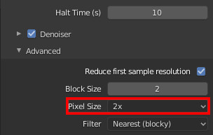

Re: Performance issues
EVEN Block size at 2X and Pixel Size at 2X is impressive to work with. So for me the most affecting setting is Pixel size. If by any trick we can render at 1/2 of the native resolution and come back after first sample it will be great :
