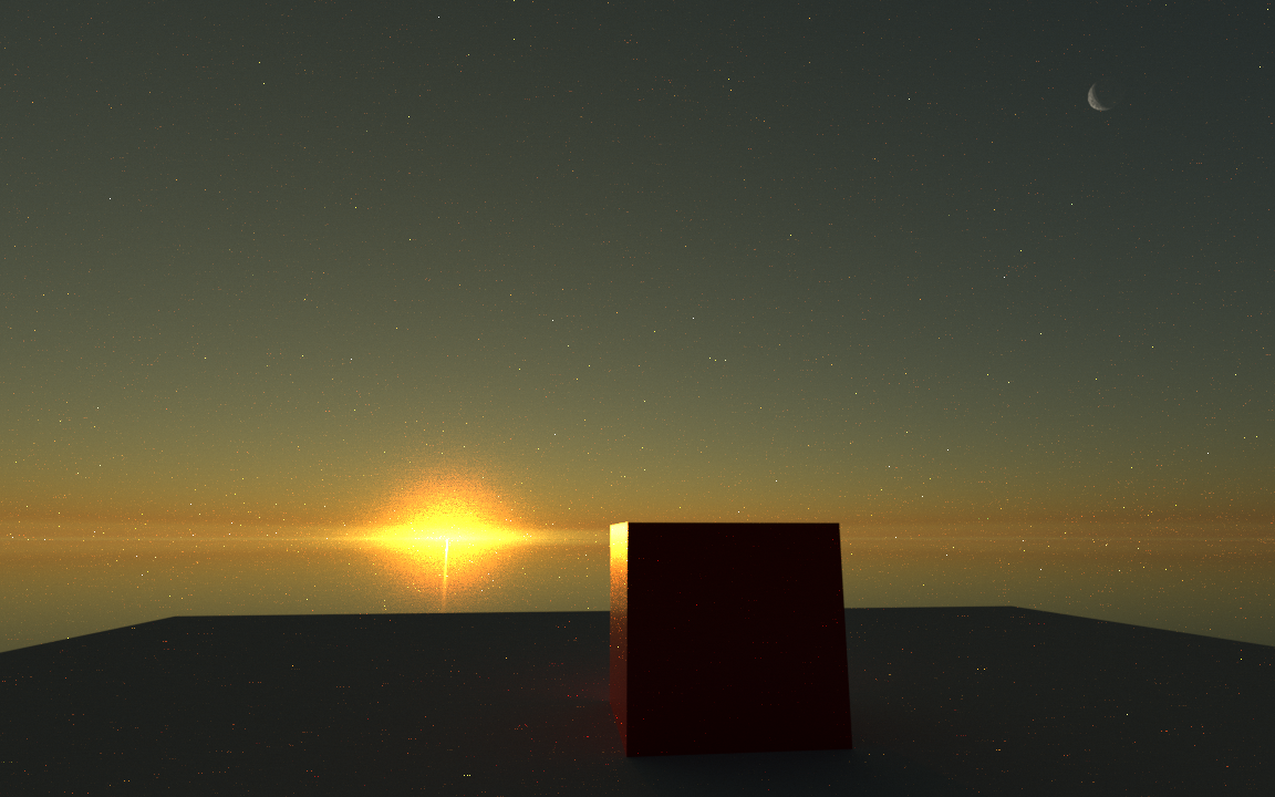

1. You also forgot to disable camera volume. I suggest removing it from blendluxcore until it fixed.B.Y.O.B. wrote: Fri Mar 06, 2020 5:57 pm When I started the LuxCore render below, I forgot to add the ocean bump map, which I fixed since, so if you render the scene you'll get a slightly different ocean surface.
2. I tried to render it with bidir, but rays/sample number keep growing while sample/sec stays 0. It doesn't happen if I hide all atmosphere objects.
3. Luxcore doesn't render hidden in viewport objects, even so they're marked for render.
Re: spectral rendering
Why, what does it change?wasd wrote: Fri Mar 06, 2020 7:36 pm 1. You also forgot to disable camera volume. I suggest removing it from blendluxcore until it fixed.
Already fixed: https://github.com/LuxCoreRender/BlendL ... issues/392wasd wrote: Fri Mar 06, 2020 7:36 pm 3. Luxcore doesn't render hidden in viewport objects, even so they're marked for render.
Use the latest daily build.
Because it's bugged.
https://github.com/LuxCoreRender/LuxCore/issues/220
This is how volume should look (red cube):
And this is how it does look with camera volume enabled
I mean, what does it change in the atmosphere scene?
Sorry, I don't know. It renders too slowly on my GPU, so I didn't check. I just can't see any reason keep camera volume enabled. It either a) doesn't change anything or b) makes something worse.
