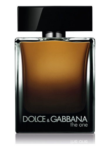

Hello, how can I make a colored gradient glass? I tried to make a mix with dark glass and clear glass, but as we don't have the gradient texture I can't make the transition. Can someone help me?
thank you.
thank you.
