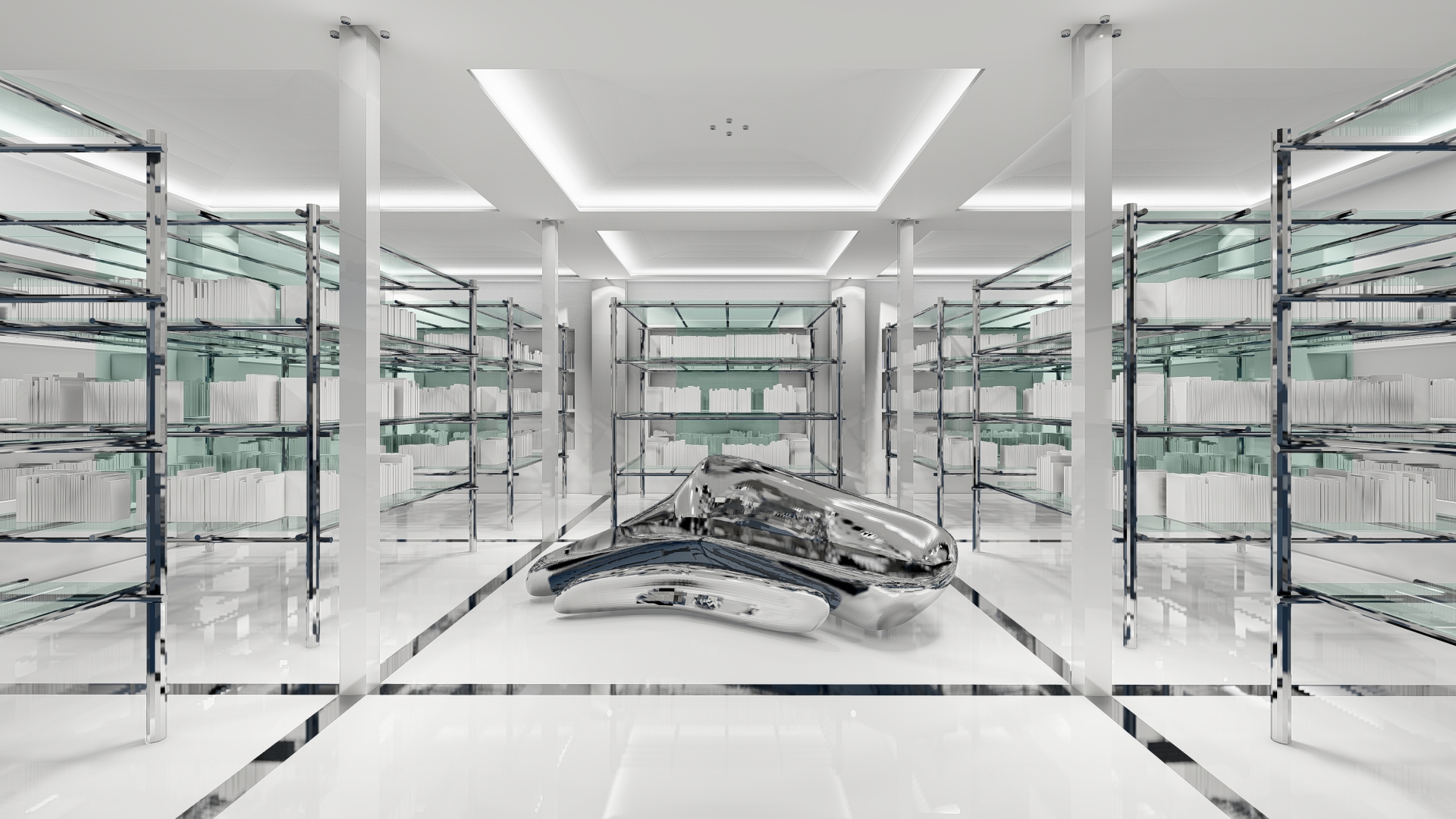

Luxcore Bidir on Ryzen 3990x
Basic set-up and advanced set-up - 8 minutes

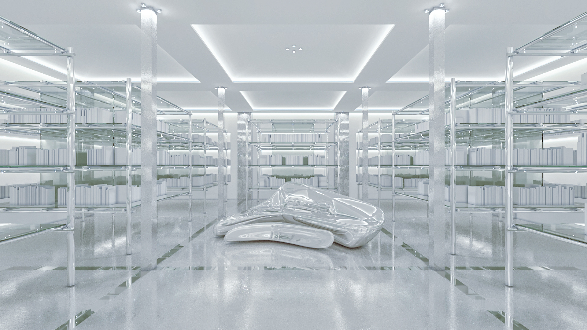

Corona 7 on Ryzen 3990x
Basic set-up - 11 minutes
Advanced set-up - 16 minutes

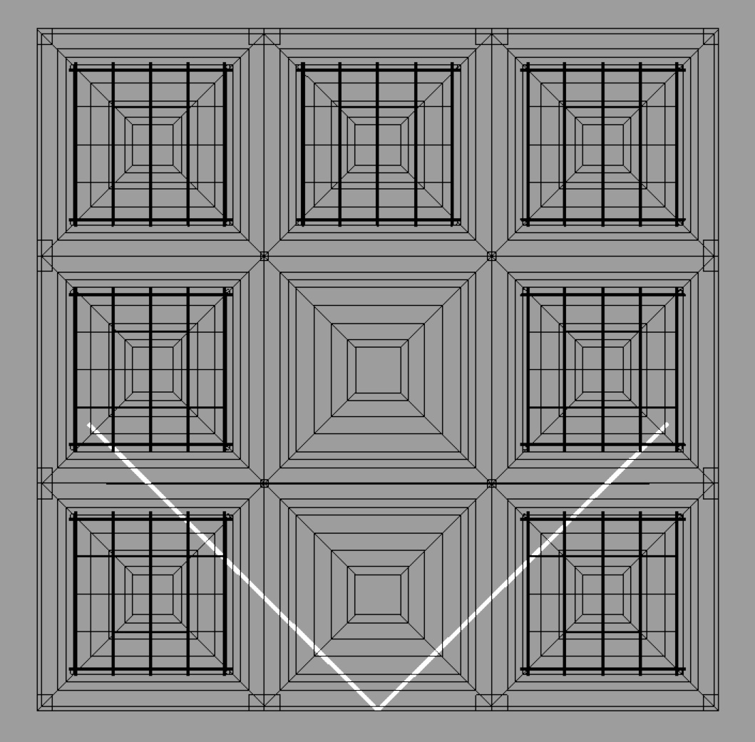

Following are the settings to replicate the tests:
Camera position: 5,0,1.2
Camera target: towards the opposite wall
Camera angle
Material and lighting description on the OBJ's layers.
Lux bidir has 24 light bounces, 256 ray bounces.
