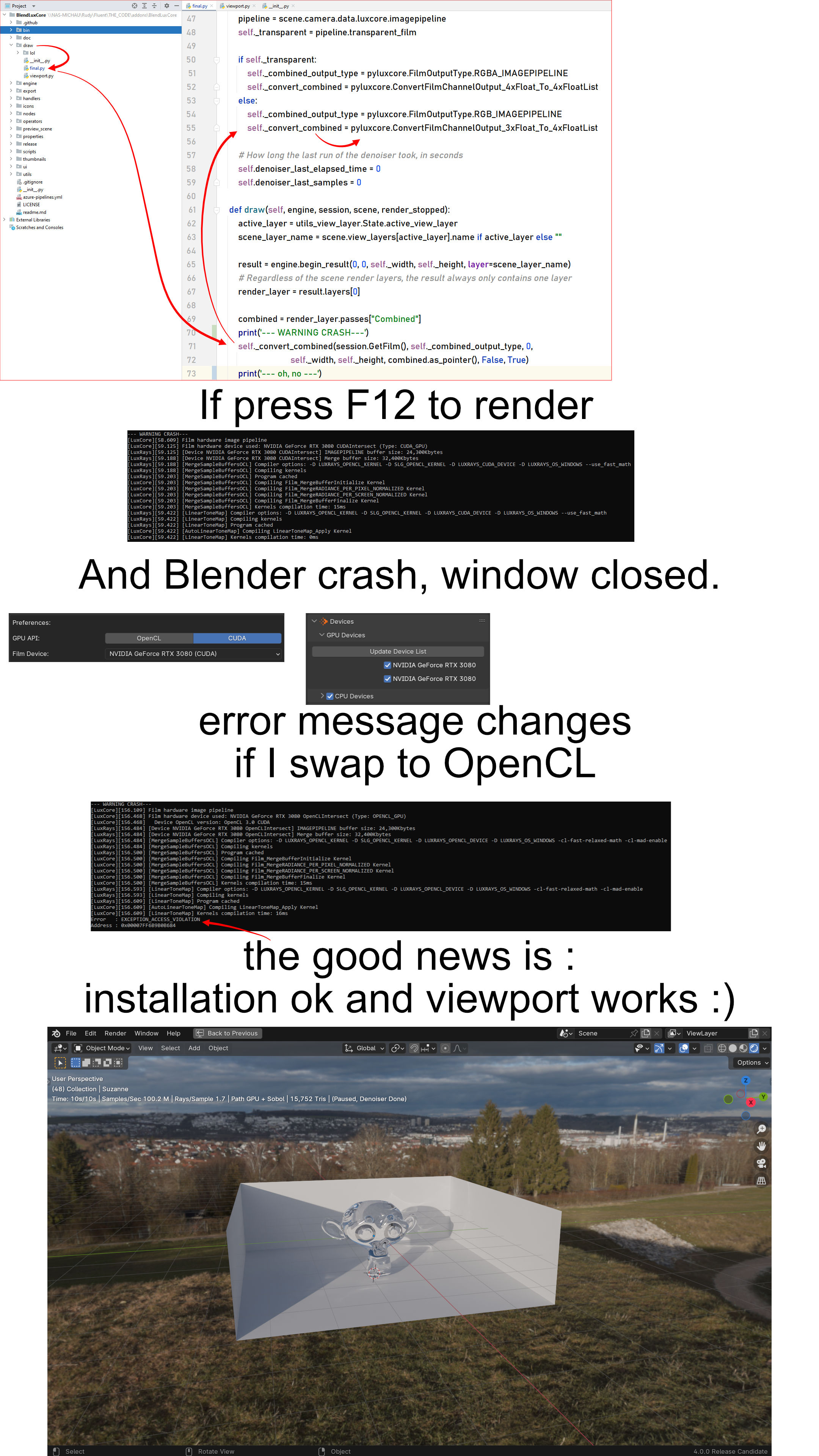

I'm working on BlendLuxcore compatibility with Blender 4. I already made changes related to new Blender API. Addon installation ok. Viewport ok. But final render crash. I need help to understand how you made the project and know if I can something.
I've added images to help you understand where I'm at with my research.
I began my work from master branch of the github.

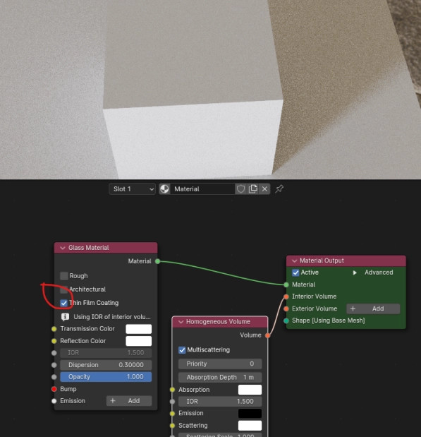

4__ thin film option in glass node turn material into matte

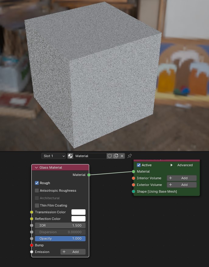

5__ Rough option in glass node turn material into matte / roughness option not visible

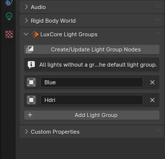

6__ Light groups options are gone

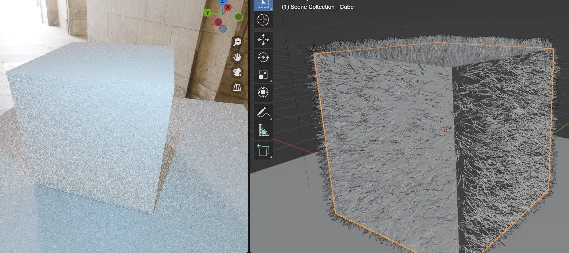

7__ Hair particles are no longer visible
8__ instanced object stop render from happening on viewport
