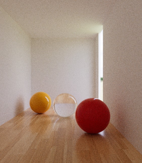

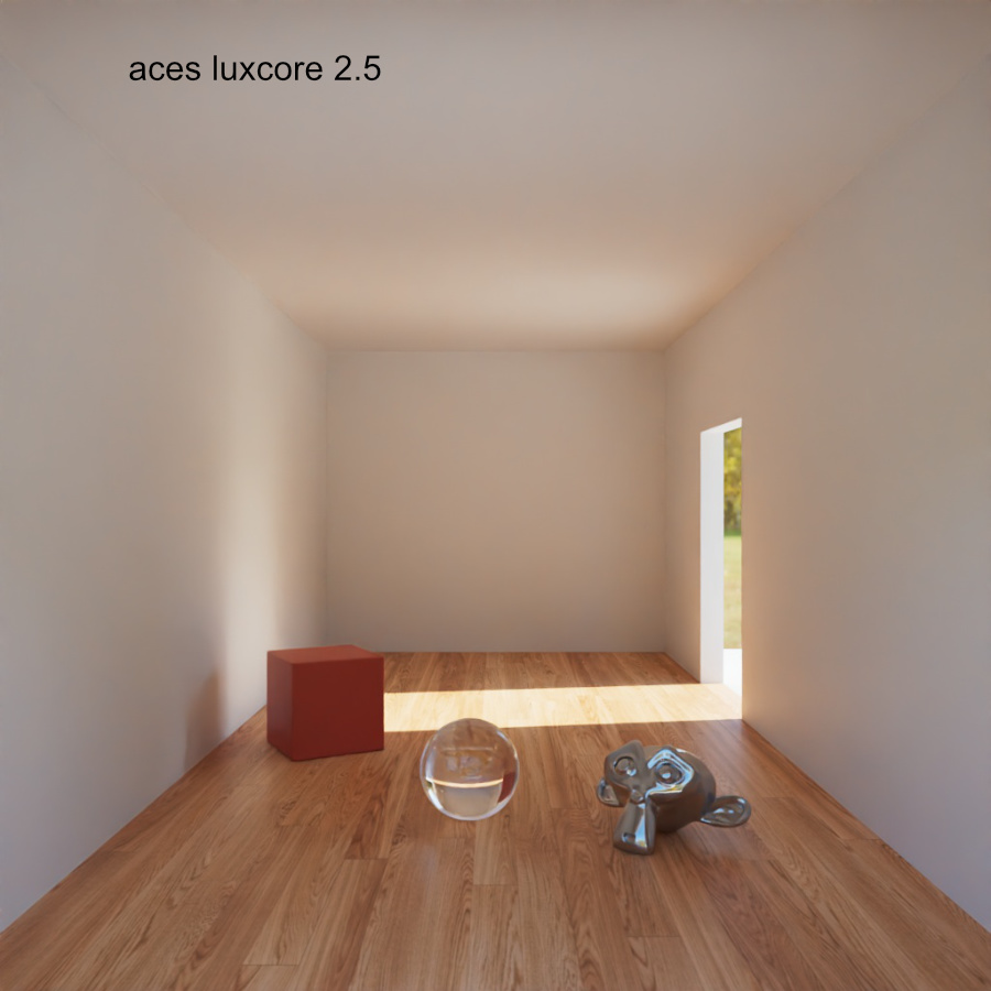

For some reason Luxcore Look a bit redish (floor texure) after I processe texture in krita :
I turned the diffuse texture gamma to 1 (exr).
Luxcore Aces
Cycles Aces
Luxcore Aces
Cycles Aces

Re: Luxcore To Aces Study
Sharlybg thank you for the gift, very nice gesture of you.
The reason for the reddish image is probably because you have enabled the gi cache, even in filmic as you can see in the following example it produces a more color bleeding image.
But to be sure you need to check first of all if the textures were converted properly(16bit diffuse map and the 32bit hdr map probably used for lighting), to do that you can open in blender's rendering tab a split view like this one:
Also you need to check if the settings both in cycles and luxcore are the same, materials , bounces, lighting, clamping, caustics.
Some questions for you, did you use luxcore 2.61, you used the disney material or the glossy, you used only a hdr for the lighting?
There are differences in how the disney shader behaves compared to cycles principledshader especially since luxcore version 2.6, so the results may not be exactly similar.
Test examples:
Test examples:
Hi Luximage you are right The reddish color was due
to the HDRi temperature color default 6500k.
With a simple white color multiplier everything is
normal.
normal.
