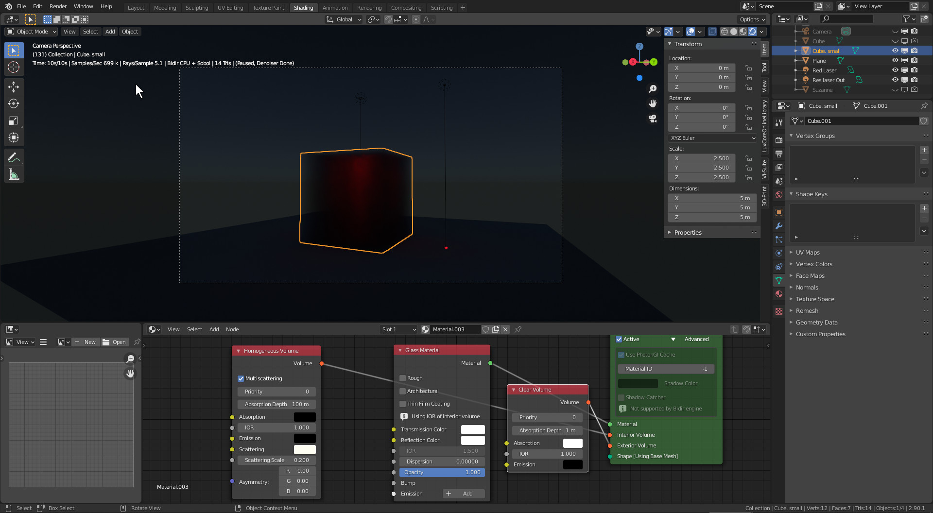

Hi, What settings to use to see a laser beam
clearly and sharply through a volume?

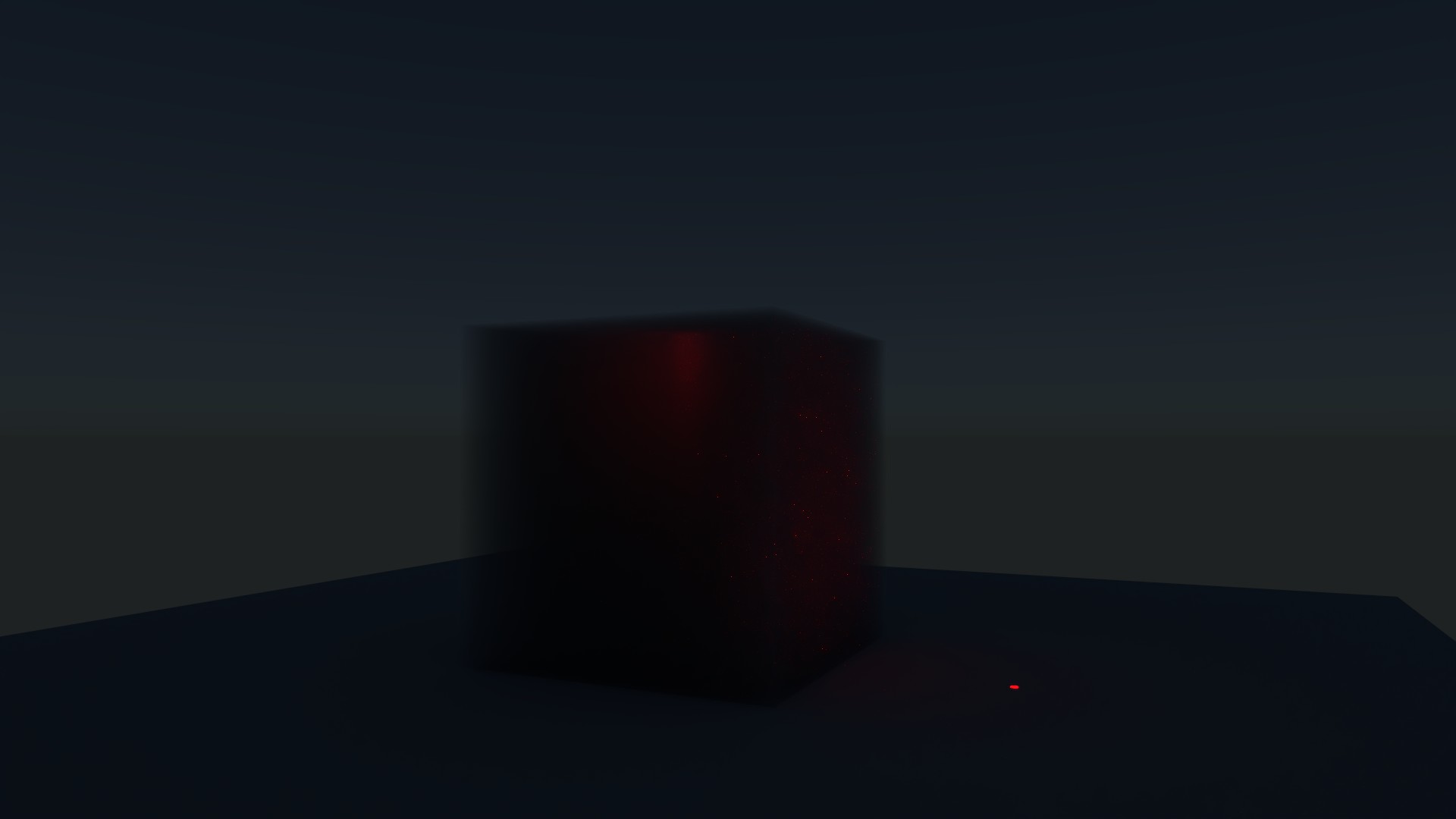

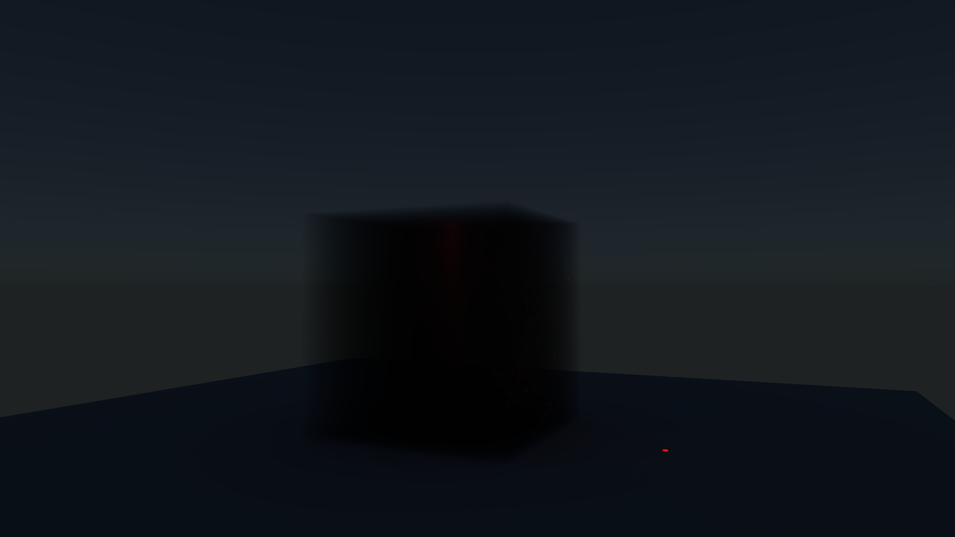

I already tried different Scattering Scale Values between 0.1 to 1 but it ends up either too faint to see or too blurred out.
Scattering Scale 0.1
Scattering Scale 1
my setup

1) Why did u use Glass Material? If u are looking for only volume affects laser - just put Null (Transparent) instead of Glass.
2) Homogen absorb colour shouldn't being black(at least completely black)
3) Laser source should be really small - now u have size of 30cm. Put some lower values (0.002 for example)
4) Increase performance for laser in lamp settings tab.
5) If using BiDir pathtracing - set Sampler from Sobol to Metropolis

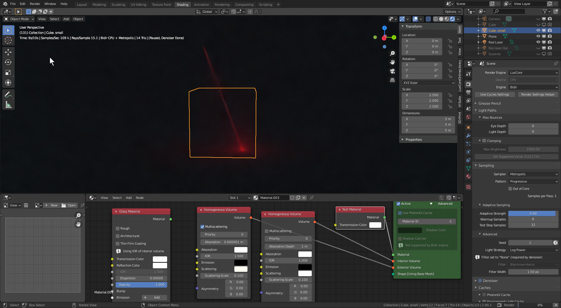

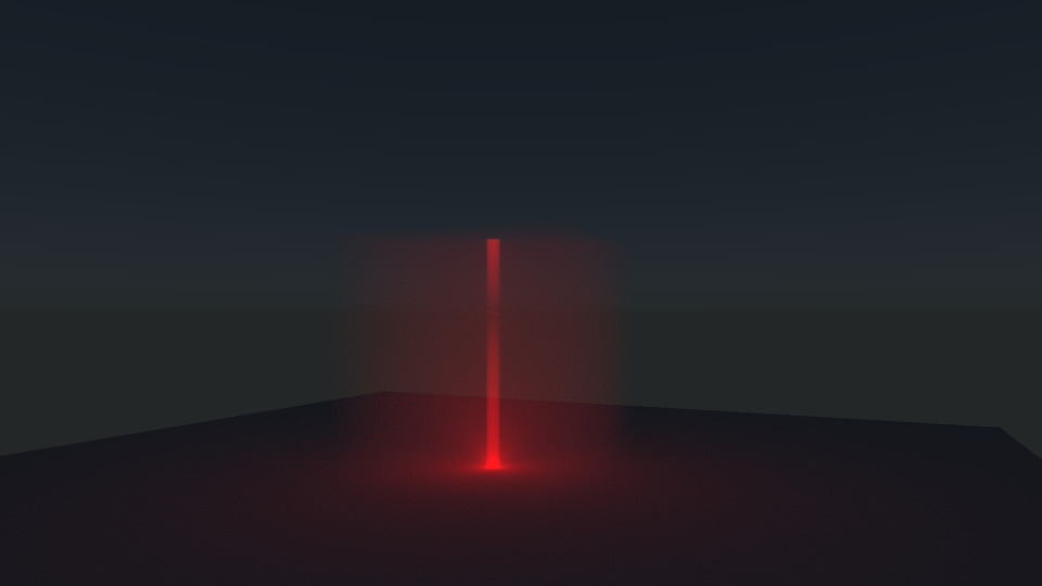

This:
1) set cube material to "null" (not glass);
2) multiply laser light source power by 10;
3) set volume absorption to 0;
4) divide volume scattering by 10
and the result is:

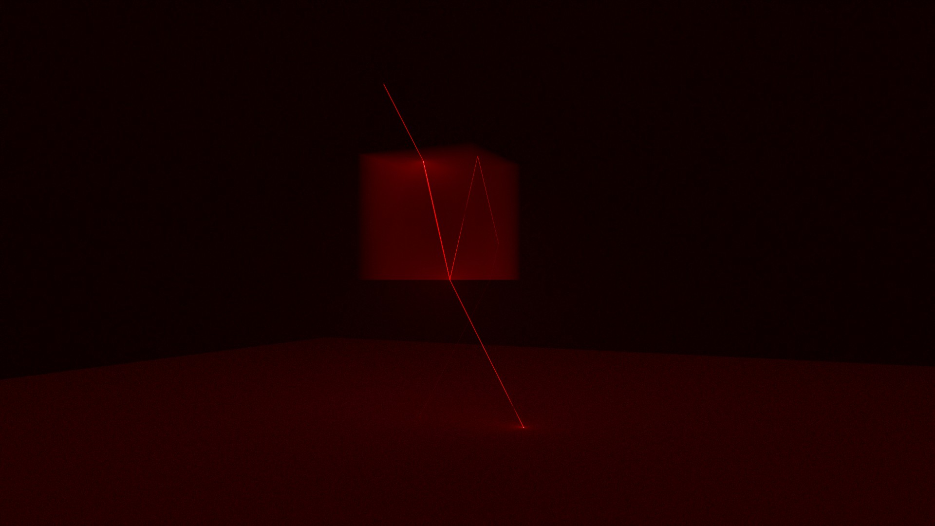

Thanks Dade. I got the laser beam refraction and reflection through glass almost working now by hiding the Glass Object from Camera. There's still something strange however and I cannot get the beam to come out visible from the glass cube beneath. That means no more light scattering after coming out and returns only after hitting and bouncing back on a Matte Plane Object???
Laser Beam
Spot Beam
Re: Laser and Volume Scatter
Posted: Fri Apr 02, 2021 7:28 am
by Jan
Thanks again! Got it fully working now. It needed another External Volume Shader Node for the Plane Object beneath the Glass Cube Object.
