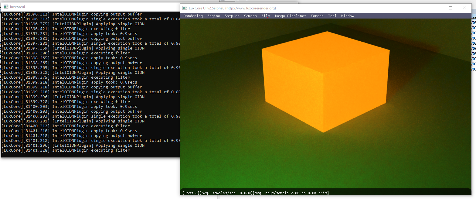

I want to report a small bug. If I start render with standalone version, set batch.haltspp = 3, the render stops at 3 Samples but there is some strange infinite loop that will apply OIDN. As you can see on attached image, render stops at Pass 3, but in console you can see OIDN that is repeated. The CPU load is very high (one core 100%) and the interface is terribly slow.
If I remove OIDN from pipeline there is nothing in Console but CPU remains very high. So it looks that the the loop is still running but without any output

I can confirm the issue.
After render hits Halt then just switching to Image Pipeline 1 (OIDN denoiser) LuxCore starts an infinite loop.

PS. After disabling OIDN (Image Pipeline 0) things return to normal - there's no excessive CPU usage (CPU load 0%)
