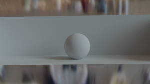

Hello! Maybe i do something wrong but i get very different and less realistic (in my opinion) result when i use PGI cash.
The scene is very simple. All PGI settings i left by defult.
![without cash.png (1.35 MiB) Viewed 4235 times without cash](./download/file.php?id=9141&t=1&sid=071507577f186616e720d6c33701d6a5)
- without cash
![cash.png (1.32 MiB) Viewed 4235 times with cash](./download/file.php?id=9142&t=1&sid=071507577f186616e720d6c33701d6a5)
- with cash
As you see in this scene PGI gives very dark gradient on the sphere. Is it normal?
I use luxcore 2.5.

It is hard to say without knowing all settings: can you post the test scene ?

When i try to attach blend file i get a messege that it is too large.
This is direct link on blend file:
https://my-files.su/Save/4d2ree/blend.blend
Also i tried to render this scene on my second PC and cash works fine.

Well... It is somehow depend on my system or something else... I will try to instal latest luxcore build.
Thank you.
Re: Path vs PGI
Posted: Sun Dec 27, 2020 11:35 am
by Endorphine
I solved the problem... The cause was russian username on my PC.
