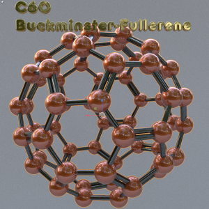

I have yesterday updated to the newest Blender version and at that chance also installed the RadeonPro Render.
So here is what i like and what not. For test-rendering i just rendered a C60-Atom from the PDB-Database.

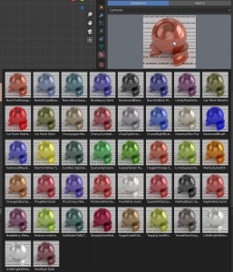

4. BIG-LIKE: A complete, User friendly Material Library is already included. Each Material already comes with a pre-Rendered Preview.
This is very user-friendly for beginners. I like the idea. (See Picture)

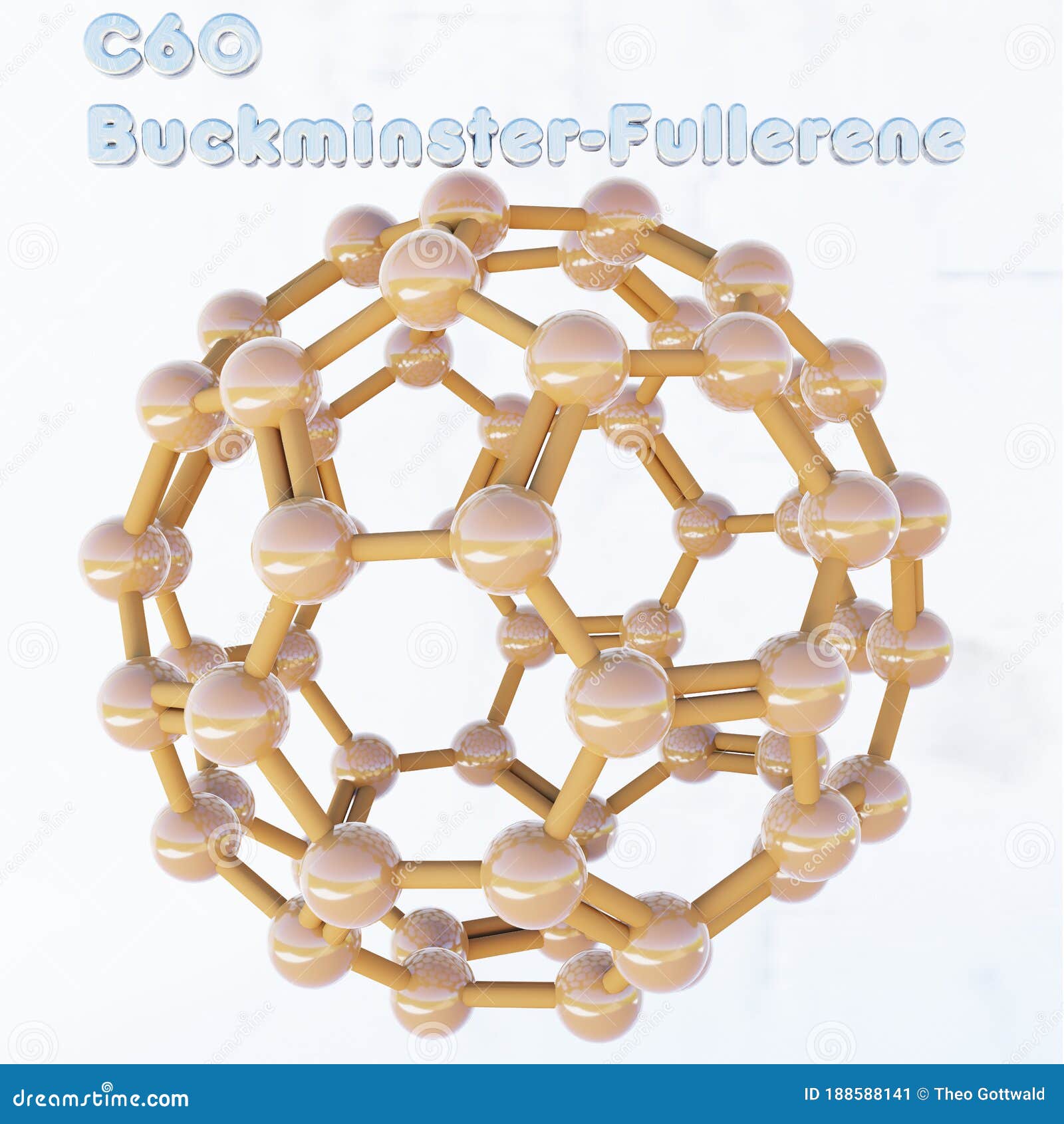

In my tests on simple Molecule-Scenes, where i rendered the equal Scene with Luxcore and Radeon-Render in 8350x8350 Resolution and same amount of Samples (But not sure i had all settings in Luxcore perfect esp. caches), Radeon Render was not even twice as fast but also used only a quarter of the Memory (See in Task Manager). However i have use Tiled Rendering because the other crashed.
So it seems to depend on the Scene which you choose for what.

Rendered with Radeon Render
Rendered with Luxcore-Render:
