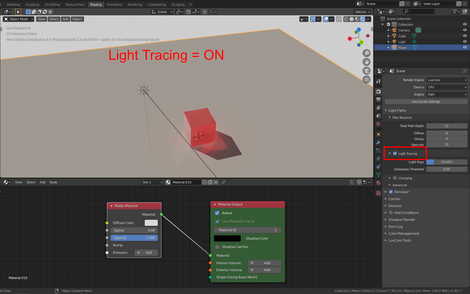

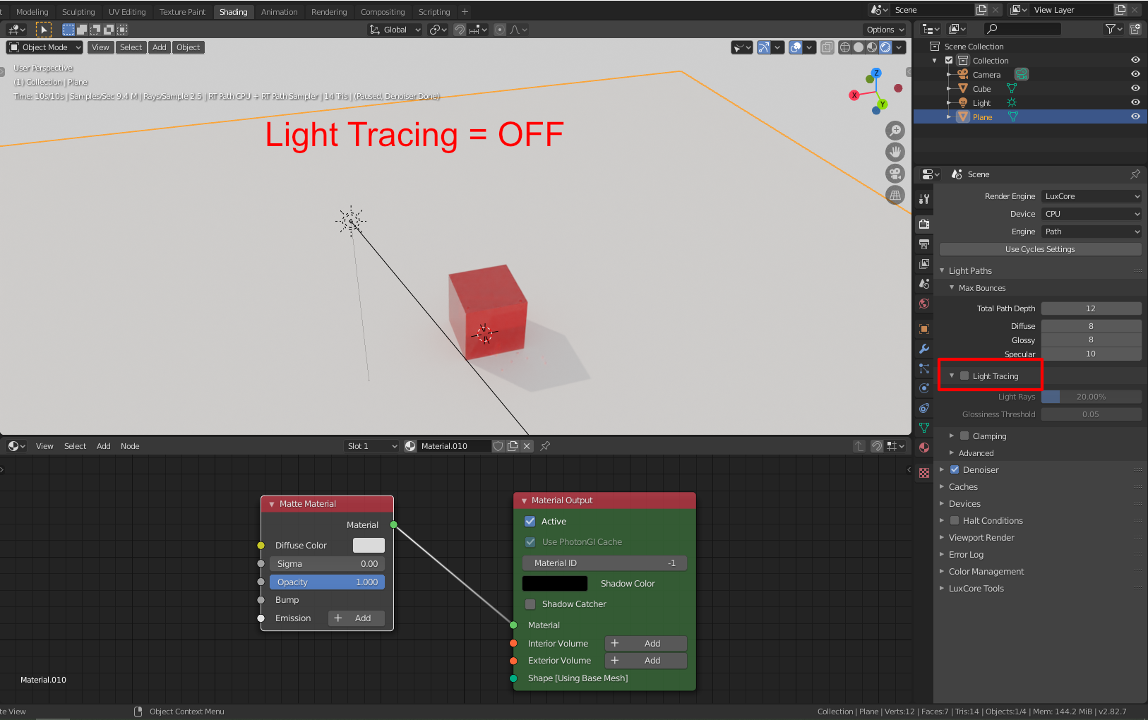

is this behavior normal in BlendLuxCore 2.4 with LightTracing?
If the LightTracing is on or off, the material colors change.
Have otherwise made no changes.
This does not happen with BlendLuxCore 2.3.
thank you

Re: LightTracing BlendLuxCore 2.3 vs. BlendLuxCore 2.4 ?
Are you using automatic tonemapping?
Can you upload the scene?

No matter whether tonemapping is on or off.
thank you
It is a view port rendering with and without light tracing (PATHCPU Vs RTPATHCPU) :?: Do you get the same results in final rendering (i.e. PATHCPU Vs. PATHCPU) ?

final rendering identical to viewport rendering :!:
by the way, everything works with the Disney material :?
as in BlendLuxCore 2.3

am I the only one with this problem ?

I have the same problem with you denon100.If i change the plane material to disney or glossy or metal with roughness included to Light tracing glossiness threshold it works ok.
win 10, xeon e5620, gtx 1050 ti
blender 2.82, latest daily blendluxcore 2.4 cuda
It was a bug in MIS code when rendering env. light sources with light tracing. I should have fixed the problem.
