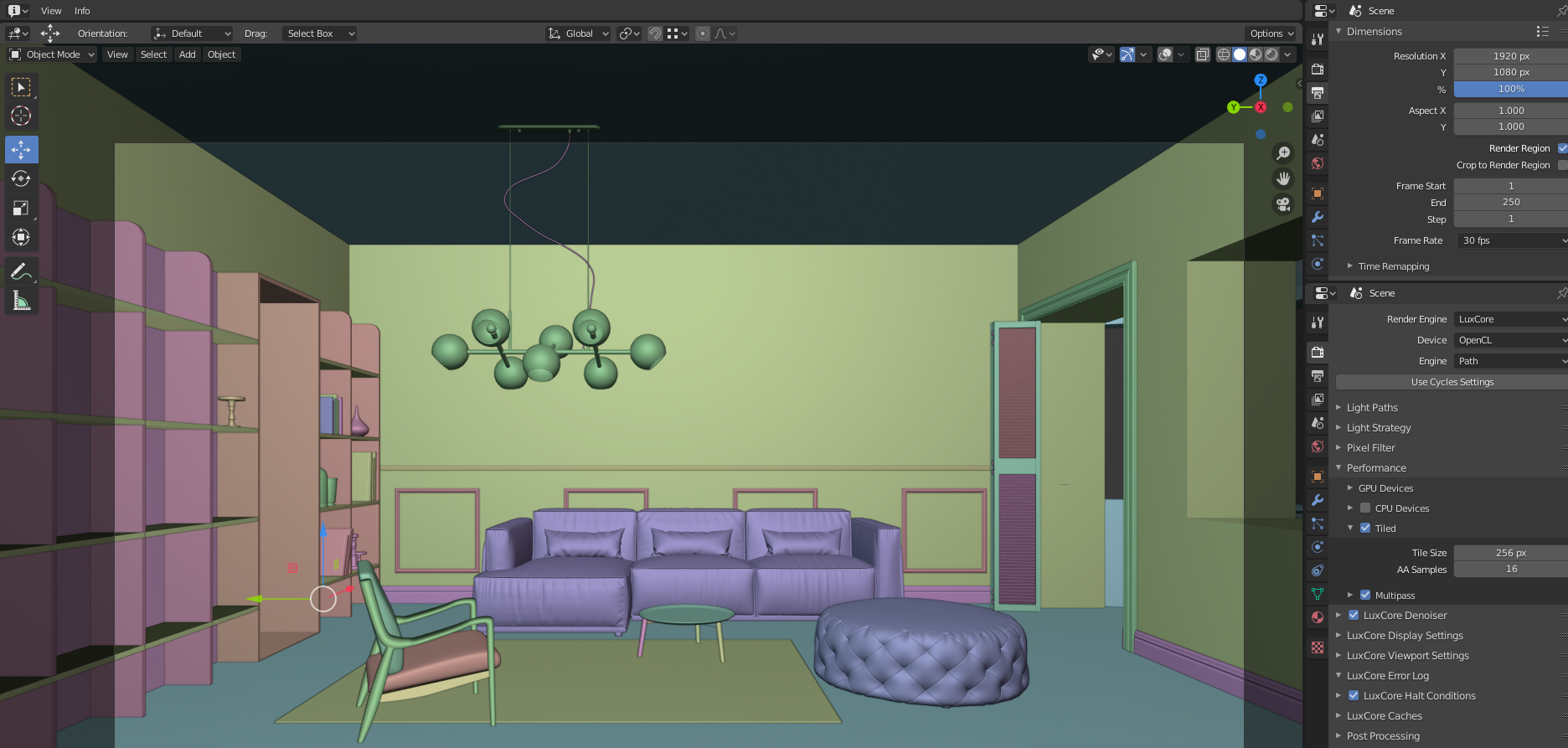

this one does not rendered in 1080 with 256 px and 16.shows black screen.It is not too complex

16 AA samples with such a big tile size is a lot. Using more AA samples requires more memory, if I remember correctly.
Re: tiled rendering for 8k,4k image
In LuxCore, rendering a tile at 256x256x16 AA is like rendering an image with 256x256x16 pixels so it is like rendering an image at 1K resolution. Plus Lux is also rendering multiple tiles at the same time so you are probably using a LOT of ram for the image.
Just use the default tile size, something like 64x64x16 or even smaller. It should solve your problem.
