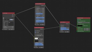

So I'm trying to create some curtains, this is the material:

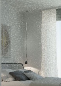

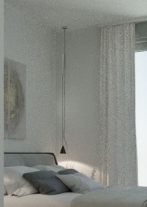

CPU Render:
OpenCL Render:
Exact same material, exact same object, exact everything.
@dade @B.Y.O.B. Any ideas of what is happening? something is not working or is broken with OpenCL right now.

Yes, it seems the problem is the mix of translucent and disney, there is a difference in brightness when you mix that, I have not tested with velvet or matte, will do.
How can I achieve a translucent curtain feeling without breaking laws of physics? hahaha

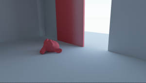

Confirmed, Disney + Translucency does somethign weird in OpenCL
OpenCL:
CPU:
Shader:
