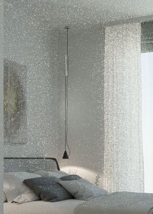

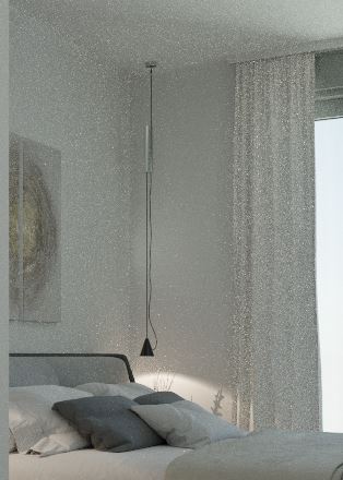

HI there.

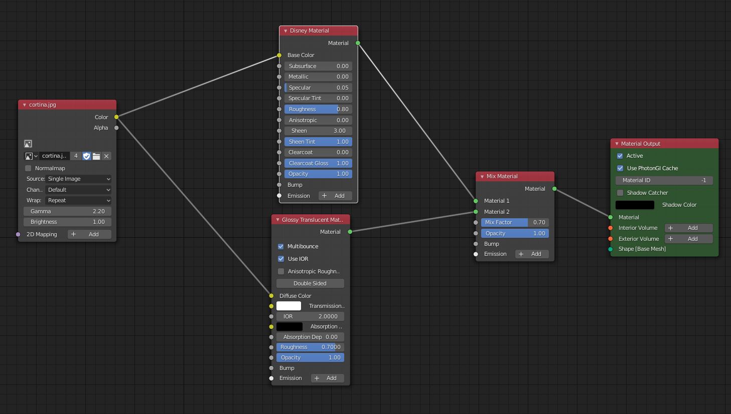

So I'm trying to create some curtains, this is the material:
CPU Render:
OpenCL Render:
Exact same material, exact same object, exact everything.
@dade @B.Y.O.B. Any ideas of what is happening? something is not working or is broken with OpenCL right now.

Mixing a solid material (like Disney) with a transparent one (like glossy translucent) can be a recipe for a lot of troubles: does it happen if you use the glossy translucent material alone ?

Post by juangea » Wed Jan 15, 2020 11:33 am
Yes, it seems the problem is the mix of translucent and disney, there is a difference in brightness when you mix that, I have not tested with velvet or matte, will do.
How can I achieve a translucent curtain feeling without breaking laws of physics? hahaha

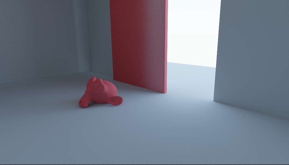

OpenCL:

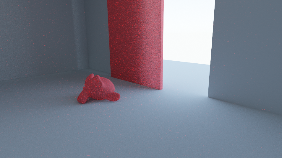

CPU:

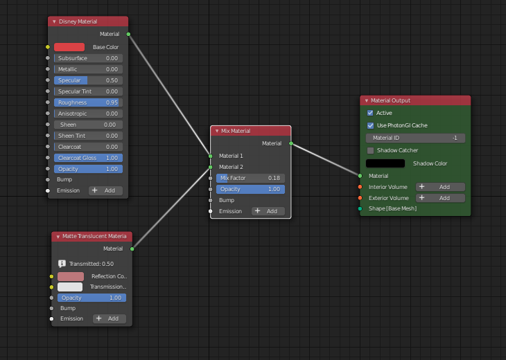

Shader:

Posts: 4887
Re: Something is off with translucency in OpenCL
Post by Dade » Wed Jan 15, 2020 4:44 pm
I should have fixed the problem: it was a bug in OpenCL code when mixing transparent and not transparent materials.
