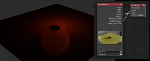

Well, now it looks like this:
So, how to remove black area and leave only glossy? I tried to add diffren keyers in compositor, but somehow they do not work.
Egert_Kanep
Posts: 239
Re: Indirect specular\glossy with alpha
Post by Egert_Kanep »
No need to key, you could pull luminance key if really wanted. But aov's are supposed to be added together. Perhaps you need something else than indirect glossy
